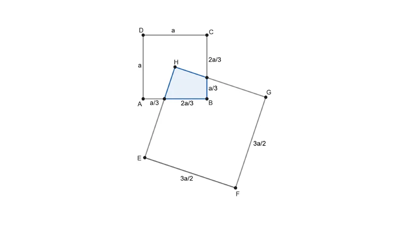

This is my interpretation of the problem statement in the original post.

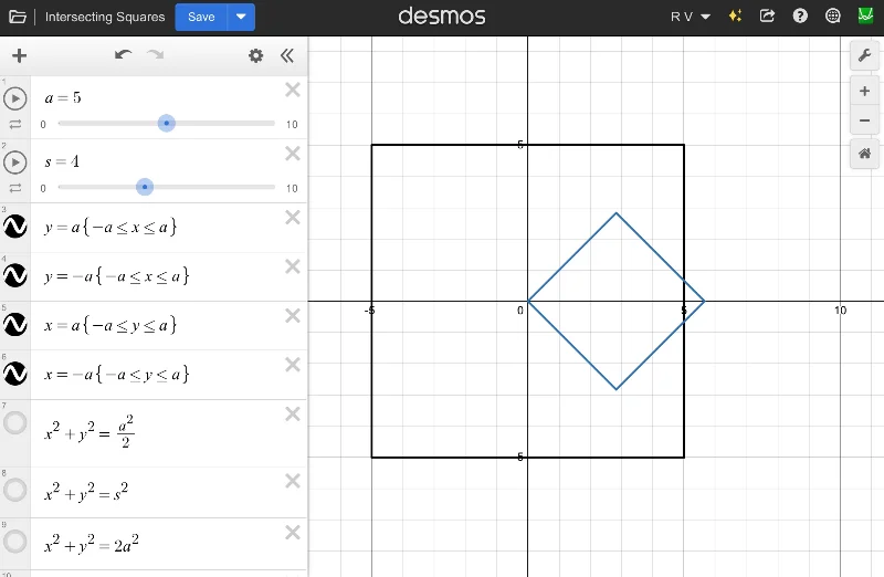

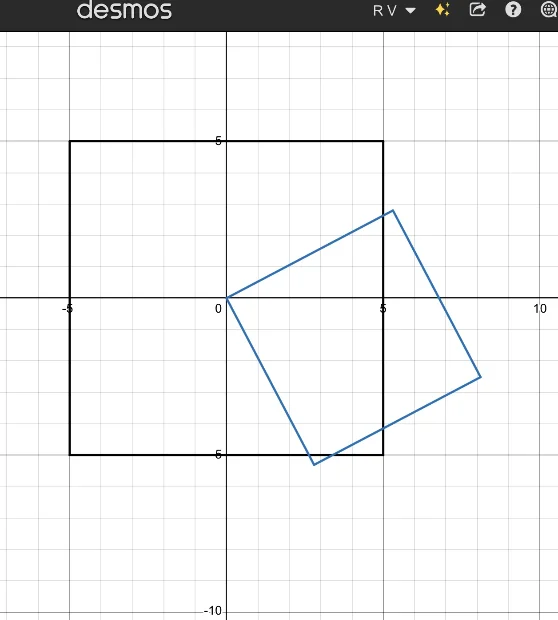

Here is my Desmos page. This is set for ##a=5## and a range of ##s## values. Note the case when ##s=a## where the critical angle is 0 meaning the function covers the entire range of angles.

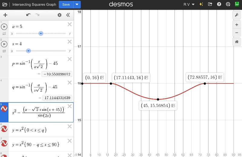

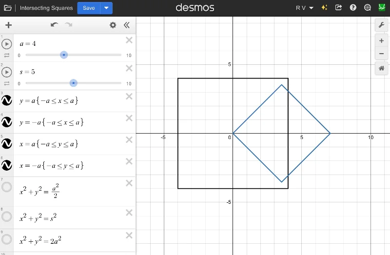

Interesting observation! It appears so if both values are within the range of the functions. Looking at ##(a,s)## being (4,5) vs, (5,4), the area of overlap is the same over the angles but they are different situations. Here are screen shots;
