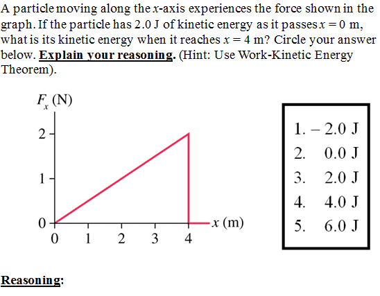

Find K at 4m, besides the F.s graph they also give me Kinitial = 2J
W=F.d and W=Kf- Ki
The first thing I did was to find the area under the graph.
1/2(4)(2)=4J W=F.d so that's my work.
Then I replaced that 4J into the other eq W= Kf-Ki
then solved for Kf.
W+Ki=Kf
plugging in values 4j +(2J)=Kf
then 6J=Kf
Is that correct guys? Thanks for your help!

looks good! Always put a space between the numerical value and the unit, 6 J not 6J.
Thank you good sir! I will next time! :D good night!
