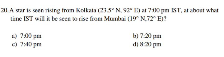

At what time will a star be seen from a place ?

Honestly speaking I have absolutely no idea about this problem . This is the first time I have seen a problem of this nature .I am not even sure which chapter of Intro Physics text does this problem belong to .
I would really appreciate if someone could help me with the problem .
Many thanks .

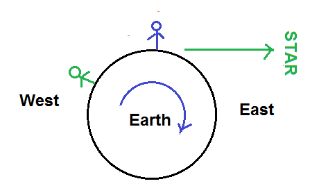

The Earth rotates... When does the green man see the star rising, later or sooner than the blue man does?

OK .
20° longitude difference = 80 minutes
Option d)
Right ?
Vibhor said:
OK .
Option d)
Right ?
I hope so. Supposing there are no big building or hills hiding the raising sun :)
