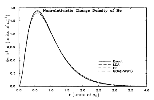

Here's what the radial charge distribution looks like for hydrogen: (in units of Bohr radiuses)
And for helium (same scale):
As you can see, it's very nearly the same curve, only the helium one has been 'compressed', radially.
Both of these curves are calculated (the helium compares some approximate methods to the exact value). The reason why the values are calculated is simple: Atomic radii can be calculated much more exactly than they can be measured.
