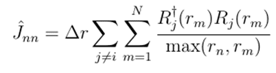

The 4th, Hartree, term the spherically averaged coulomb repulsion an electron feels from all the other electrons. It is also diagonal and represents the average coulomb force experienced by the ith electron by all others. It, and the exchange term require knowledge of the position radial wave functions of the other electrons. I am familiar with the algebra to derive the expression as written.

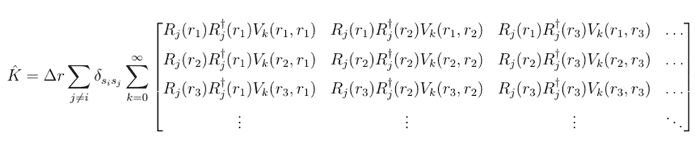

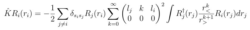

The exchange term, K, is a dense matrix also dependent on the other wave functions, but also on the spin and angular momentum relations between the electrons. The V_k term is found in the paper and is related to the wigner 3-j terms. The last student to do this problem couldn't achieve convergence with this matrix and had to make an approximation. Tonight I'll implement that change and see if it's the real issue, but I don't see why this expression won't work.
