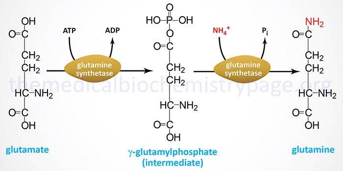

Consider for example, glutamine synthetase, which catalyzes the reaction of glutamate (glutamic acid) to glutamine.
By starting certain reactions at the top of the slide, cellular processes can overcome the thermodynamical "cost" of running reactions.
