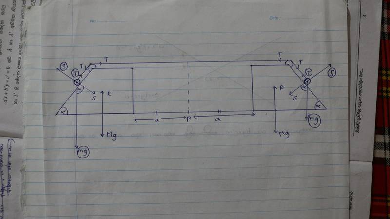

1. Homework Statement
It's an auto closing gate. Two parts of the gate are identical. I had given to find the time taken to close the gate. The distance to close point (P) of the gate from closed event of the gate is given as "a". Sorry for my bad English.
What i need to know is how the two masses (which are m connected by a wire through two pulleys which are on the two gate parts move in relative to the gate parts. Masses of the gate parts are M and magnitude of the inclined plane of the gates are α. again sorry for my bad english. I have attached the image of the problem.
URL]
Hand-drawn free-body diagram of an auto-closing gate: two identical gate panels with inclined planes at angle α, pulleys, tension T, normal force R, friction-free sliding mass s, weights Mg and mg, and distance a from each panel to point P.
what i need to know is how the masses (m) move.
Then i can mange to work on the acceleration of the gate part and use constant acceleration equation which is s=ut+1/2(at)^2
Oh and no friction is involved and the wire is nonelastic.
This is my first thread on this forum. Sorry for my bad English. Thank You! :wink:
What i think is that when two gates are getting closer the masses (m) are going downwards on the inclined plane on the gates.

By symmetry, the middle of the wire is fixed, so only need to analyse one side.
With this type of problem, it can be easier to work in the reference frame of one of the accelerating objects, the gate in this case. That will involve use of pseudo forces. Are you comfortable with that, or do you prefer to work always in the ground frame?
Thank you so much for replying. But I am supposed to work on ground frame. When the gates are fetting closer two masses should move downwards on the plane right? Or since they are attached to one another are they suppose to move on a same direction (not exactly same direction, like when one goes down other should go up) ? When that also happenes the gates should close right? Beacuse the forces applied on the gate parts don't change with the direction masses go? Hope you understood that. Thank you for advice that i should woek on one gate :)
I think you meant that middle poiny is fixed that they are moving downwards when gates getting closer am i right?

Yes. There is mirror symmetry, so the two masses will move in mirror symmetry.
The tricky part is the direction of acceleration of a mass.
This is what I am currently working
IMG_20170913_110938_zpssn5rvo8d_edit_1505281688474_zpssqzprpx6.jpg.html
on is this correct to mark acceleration dirrection like that? I mean it'll look like they are trying to move opposite directions right? Thank you so much sir!
Also forced involved to move a gate are one of the perpendixular forces from "m" mass and (T - Tcosa) right?

No, it's trickier than that because of the mass's own acceleration. Let the normal force be N and derive the accelerations in terms of that.

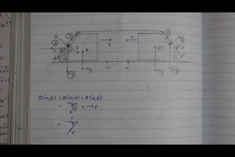

If i marked the acceleration like this and calculated acceleration in relative to Earth would that be correct?
Handwritten free-body diagram of two blocks on inclined planes joined by a string over a pulley, with forces F, T, R, mg, f and angle alpha labelled, and an equation a(m,E) = a(m,M) + a(M,E) below.
Could be... it's a bit hard to tell from that. Please post some equations, not as an image. And please define your variables.

I have chosen the left side gate. I have calculated the acceleration of mass m like this (e-earth)
I took,
F as the acceleration of left side mass M in relative to Earth and, {a(M,e) = F→}
f as the acceleration of left side mass m in relative to mass M {a(m,M) = f in parallel to inclined plane}
\begin{equation}
a(m,e) = a(m,M) + a(M,e) \\
= f \swarrow α + F\rightarrow \\
\end{equation}
by using F=ma
\begin{equation}
To "M" f=ma→; \quad T-Tcosα+S.Sinα=MF \quad\quad\quad\quad -1 \\
To "m" f=ma \swarrow α ; \quad mgsinα-T=m(f-Fcosα) \quad\quad\quad\quad -2\\
To "whole" f=ma → \quad ; T=MF+m(F-fcosα) \quad\quad\quad\quad -3\\
To "m" f=ma \nwarrow (perpendicular\quad to\quad plane) \quad ; \quad S-mgcos∝=m(-Fsin∝) \quad\quad\quad\quad -4\\
\end{equation}
Please check these are correct with the diagram i sent. If those are correct then i got 4 equations to find "F→" which is the acceleration of Left Gate part in relative to Earth. Also I'm not sure with equation #4 :/

Your four equations look right to me.
Ok Thanks!
Then i have to use \begin{equation}
s=ut+(1/2)at^2
\end{equation}
and it's initial velocity is 0 and calculate time taken by the gate to it's closing gate which is S=a and get positive value by the square root because time cannot get minus value right?
