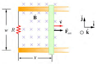

What is the induced magnetic force on this closed current loop?
12 replies · 3K views
zenterix
774
84
In the figure below we have a conducting bar (green) moving through a region of uniform magnetic field ##\vec{B}=-B\hat{k}## by sliding along two frictionless conducting rails (orange) that are a distance ##w## apart and connected together by a resistor with resistance ##R##.
Let an external force ##\vec{F}_{ext}## be applied so that the conductor moves to the right with constant velocity ##\vec{v}=v\hat{i}##.
Below I will go through derivations I saw in some notes from MIT OCW's 8.02 "Electricity and Magnetism".
We thus have a closed loop.
Let the normal vector be ##\hat{n}=\hat{k}##.
Then, the area vector is ##\vec{A}=A\hat{k}##.
The magnetic flux through this loop is
$$\Phi_B=\vec{B}\cdot\vec{A}=(-B\hat{k})\cdot (A\hat{k})=-BA=-Bwx$$
and
$$\frac{d\Phi_B}{dt}=-Bwv=-\mathcal{E}$$
where ##v=\frac{dx}{dt}##.
Thus,
$$\mathcal{E}=Bwv >0$$
which means that relative to our choice of normal vector, the current ##I=\frac{\mathcal{E}}{R}## flows counterclockwise.
A charge carrier with charge ##q## in the moving bar experiences a magnetic force
$$\vec{F}_B=q\vec{v}\times \vec{B}$$
$$=qv\hat{i}\times B(-\hat{k})=qvB\hat{j}$$

And now we get to my question.
We have already determined that there is a counterclockwise current in the bar and rails.
Therefore there is an induced magnetic force ##\vec{F}_{ind}## experienced by current in the bar as the bar moves to the right given by
$$\vec{F}_{ind}=I(w\hat{j})\times (-B\hat{k})=-IwB\hat{i}=-\left ( \frac{B^2w^2v}{R}\right )\hat{i}$$
that is in the opposite direction of ##\vec{v}##.
For the bar to move at a constant velocity, the net force acting on it must be zero. This means that the external agent must supply a force
$$\vec{F}_{ext}=-\vec{F}_{ind}=\left (\frac{B^2l^2v}{R}\right )\hat{i}$$
What the heck is this induced magnetic force?
It's called the Lorentz force

The induced magnetic force I am asking about is actually something kind of obvious that I simply missed.
The velocity of the conducting bar as a whole to the right means that a charge carrier in the bar feels a force ##\vec{F}_B=qvB\hat{j}##.
From Faraday's Law, we know that this generates an emf in the loop which generates a counterclockwise current.
A charge carrier in the conducting rod now has a component of velocity in the ##\hat{j}## direction.
The induced magnetic force is the new component of magnetic force on the bar due to this new direction of velocity.
It acts in the ##-\hat{i}## direction and has the effect of decelerating the bar. We can compute the force as follows
$$\vec{F}_{ind}=\int_{bar} Id\vec{s}\times\vec{B}=I\left (\int d\vec{s}\right )\times B(-\hat{k})$$
$$=Iw\hat{j}\times B(-\hat{k})$$
$$=IwB(-\hat{i})$$
$$=\left ( \frac{Bvw}{R}\right )wB(-\hat{i})$$
$$=\frac{B^2w^2v}{R}(-\hat{i})$$
For the bar to keep moving with a constant speed, the external force must be ##-\vec{F}_{ind}##.
