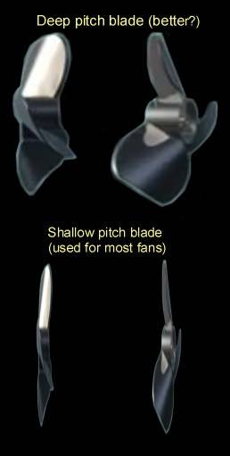

KalamMekhar, thanks for that video. I thought of having a small slant (well, curved piece) at the edge just like what's shown in the video. It seems so obvious to prevent the sharp part of the blade from chopping up the air so harshly. I find it pretty amazing something like that isn't already in use on fans/helicopter blades generally. Can they really all be missing that? Maybe I'm missing something, and there's more to it than that?
Another factor I just don't get is why almost every fan manufacturer decides to use a flat blade design, when a deeper pitch/depth to the blade would quieten the whole thing down. Correct me if I'm wrong, but although it requires more power to rotate a deeper blade, this is offset against the amount of air that's being pushed. Equivalently, the RPM is slower and quieter, but would push just as much air compared to a flatter blade design. I'm guessing that the ideal depth for a blade to be would be the diameter of the blade, or the radius maybe.
But hey, for all I know, a very deep cylindrical blade/helical design might be even better in terms of quietness.
Wind farm blades are usually pretty flat too. Why also can't they use deeper pitch blades?
For axial (bladed) fans, you are correct: a twisted and cambered blade is substantially more efficient than a flat blade.

Can you think of any reason why the fan manufacturers go for a flatter blade design? (Vornado being one of the exceptions it would seem).
Even ceiling fans seem to suffer from this problem. For example:
Interesting about the wind farm fan blades. They appear at least very stick-like. Do you know how well they would perform if they used a large scale version of the deep pitch design shown at the top of the image below:
