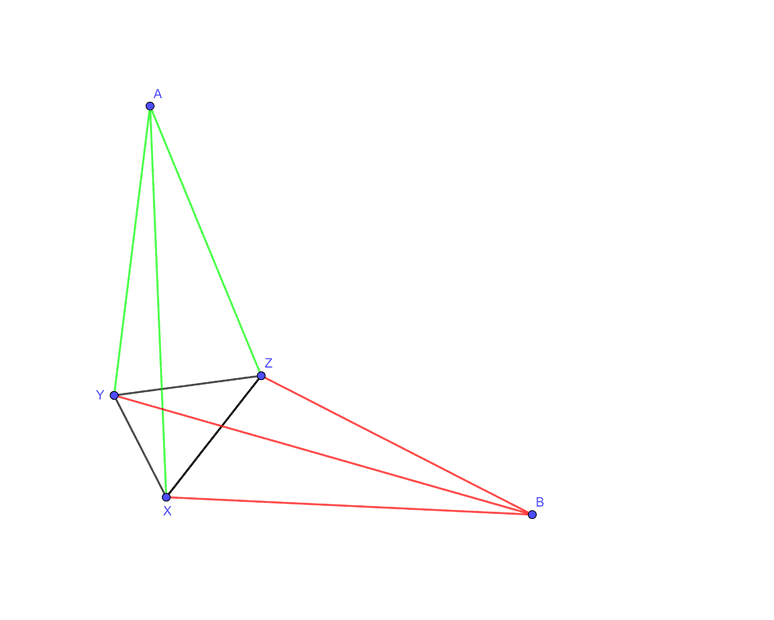

Imagine you have five points on a flat plane. Name the points A, B, X, Y and Z. The position is arbitrary but fixed. The points X, Y and Z act as reference points. Points A and B are just some other points. Imagine now, that you know the following distances: The distances between the reference points X, Y and Z: XY, XZ, YZ. The distance of each reference point to points A and B: XA, YA, ZA, XB, YB, ZB.
Calculate the distance between points A and B.
a^2+b^2=c^2
Dear all,
the following problem is not a home-work problem. I have come up with this question for myself. Nevertheless, I am stuck and need your help.
The question is: Can I calculate the distance between points A and B from this information? And if yes, how?
I think it should be possible. However, I do not know how to go about it.
These are my considerations so far:
The points X, Y, and Z form a kind of reference frame. Every point P on the plane is described by a unique combination of distances between the point and the three other points.
However, the difference is the following: In a coordinate system with two axes x and y, any combination of values for x and y will always return a valid point. In the case of the reference frame X, Y, and Z only very special combinations of three numbers/distances describe a point. Geometrically this can be shown as three circles around the points X, Y, and Z. Only those combinations of circles, that intersect in one point, define one specific point P. All other combinations do not describe a point. Inversely this can be drawn as three concentric circles around the point P where each of the circles goes through one of the fixed points.
In a cartesian coordinate system, I can also add this extra parameter in the form of the distance between the origin (0,0) (or any other arbitrary and the point P (x,y) that I want to describe. However, this additional distance adds no further information.
In a cartesian coordinate system, I can convert the two-dimensional coordinates (x,y) of a point P into three distances. A simple example would be:
  • the distance between the P and the origin (0,0)
  • the distance between P and the point (1,0)
  • the distance between P and the point (0,1)
I can calculate the distance between P and those points using the Theorem of Pythagoras.
However, in my problem, the distances between the three points X, Y, and Z in the basic problem are not (necessarily) 1 and there are not (necessarily) any right angles.
It is also possible to write all those distances in the form of vectors and matrices, however, this gave me no further idea.
I also had the hunch to I think of the distances as radii of circles. If I do so, I can subtract the areas of those circles and calculate the radii of the resulting circles. However, by trying to do so I got lost and none of the results I got was meaningful. But I still think this is the way to go…
I think this problem cannot be new, but I have no idea where to look for a solution and I am stuck with my own ideas.

Have tried to reproduce the shape on a paper using only a compass?
Possibly the fact that you have three reference points is adding to the confusion. You can almost get by with only two (for instance, X and Y). The third point just allows you to disambiguate between the two distinct sides of line XY.
With just the length of the base of a triangle (line segment XY) and the lengths of two sides (XA and YA) can you compute the perpendicular distance from line XY to point A?

Consider, for example, ΔABX. Let θ= ∠AXB.
Since AX and BX are known, we can find AB using the cosine rule providing we can first find cos(θ).
θ is the sum of ∠AXZ and ∠ZXB and the cosine (and thence sine) of each of these can be found from the known lengths and cosine rule.
There may be some special cases to consider, e.g. if A and/or B are inside ΔXYZ.

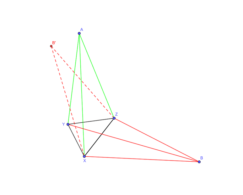

Hi @Steve4Physics
the hint to the cosine rule was helpful. However, I am not interested in this specific case depicted in the diagram or in any other specific case. I am looking for the most general solution,
If I ignore the distances YA and YB, I cannot know from the other distances only, what the figure looks like, For example, point B could have two positions. See the below diagram at B'.
Maybe I must rephrase my question:
Is it possible to calculate the distance between two points A and B on a plane without any further consideration if the following information is given?
  • Distance between A and three arbitrary points X, Y, and Z
  • Distance between B and the same three points X,Y, and Z
  • Distances between the points X, Y, and Z
In a way, I am looking for an algorithm/equation to calculate the distance AB, the same way I am able to calculate the distance between A and B with the Theorem of Pythagoras in a cartesian coordinate system.
A few thoughts…
My suggested (Post #5) approach could be modified. For example, two formulae for AB could be derived - one by considering ΔABX and the other by considering ΔABY.
Then, possibly, from these two formulae, a third formula (or algorithm) could be constructed which satisfies both of the initial two formulae and contains all the given distances. This third formulae (or algorithm) would be the general one you want.
Also, can I note that it is risky to assume that a single formula (analogous to the theorem of Pythagoras) exists for your system. It may – but it’s a big assumption.
I believe you need to consider all potentially distinct cases.
The ‘topology’ (though not quite the right word) changes depending whether or not A and/or B are inside/outside ΔXYZ Assuming the existence of a single formula/algorithm which works in all situations seems optimistic!

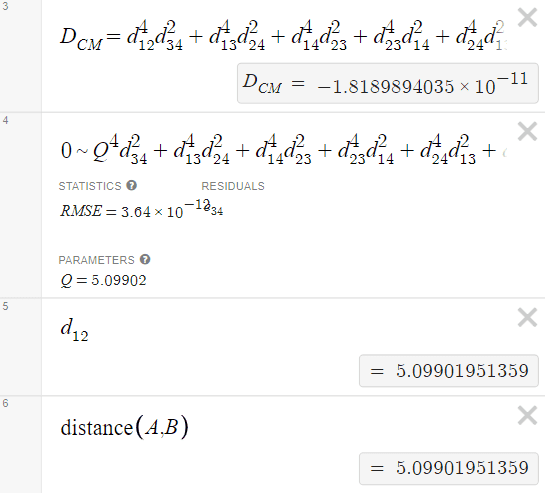

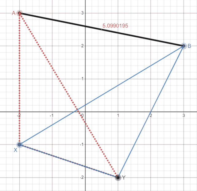

Check out my implementation at https://www.desmos.com/calculator/9qpqekeqvx
[ slight modification: https://www.desmos.com/calculator/rgeqfdc3ob ]
(move the points around!)
[See further update (described below the horizontal line): https://www.desmos.com/calculator/rdwho5iodf ]
I implemented the formula posted by @Steve4Physics (derived from the Cayley-Merger Determinant) from https://mathworld.wolfram.com/Quadrilateral.html
(See the formula below in MathJax. Note that Desmos uses LaTeX-like notation, when copy-pasting.
Since I already typed it in, it's easier for you to do something else with it.)
The 4 points A,B,X,Y yield the 6 lines that are featured in the determinant.
I evaluated that determinant, which gives ##0\pm10^{-10}##.
Then I did a regression in Desmos for a variable ##Q## which plays the role of the "distance from A to B" if "0=determinant" with that ##Q## (treated as free) is solved for.
Compare that ##Q## (from regression) with Desmos's distance function.
(pasted from Desmos... reformatted manually)
NOTE: These expression can be simplified because the distance functions are symmetric: ##d_{21}=d_{12}##.
They were likely written without using this fact in order to systematically generate all of the appropriate terms... keep track of them.
So, for doing algebra and solving,
one can essentially reduce the number of terms by about half.
An orderly method is to: write any term ##d_{ba}## with ##b>a## as "##d_{ab}##".

So, that Desmos can do its regression (Q is now the squared-distance)
0\sim Q^{2}S_{34}+S_{13}^{2}S_{24}+S_{14}^{2}S_{23}+S_{23}^{2}S_{14}+S_{24}^{2}S_{13}+S_{34}^{2}Q+QS_{23}S_{31}+QS_{24}S_{41}+S_{13}S_{34}S_{41}+S_{23}S_{34}S_{42}-QS_{23}S_{34}-S_{13}S_{32}S_{24}-QS_{24}S_{43}-S_{14}S_{42}S_{23}-S_{13}S_{34}S_{42}-S_{14}S_{43}S_{32}-S_{23}S_{31}S_{14}-QS_{13}S_{34}-S_{24}S_{41}S_{13}-QS_{14}S_{43}-S_{31}QS_{24}-S_{32}QS_{14}

All I did was use the webpage and formulas that @Steve4Physics provided.
In Desmos, I created 4 points (controlled by 8 sliders... x and y for each point).
I defined a functions that correspond to the Pythagorean-theorem-distances between specific points (to be used in the formulas provided by Steve4Physics).
One claim from the webpage is that a certain function of all of those distances add up to zero.
(It's the determinant of a particular matrix where particular functions of these distances appear.
The determinant measures the volume of a tetrahedron, given its lengths. But since all four points lie on a plane, the tetrahedron is flat and its volume is zero.) So, we are checking it with our knowledge of all the Pythagorean-distances.
From this idea, one can leave out one variable (the distance from A to B) and solve for it
in terms of all of the other distances (taken to be "known", via the Pythagorean-distance).
That's what the "regression" does... solve numerically for the distance from A to B using that formula.
Along the lines of what Steve4Physics suggested trying to solve a quadratic formula,
I used Maple (which can do algebra symbolically),
and asked it to write (the distance from A to B) as an explicit formula
in terms of all of the distances (using the formulas provided by Steve4Physics).
So, I entered that as a formula for Desmos to evaluate.
So, I got Desmos to
  • verify the zero value of the determinant (the volume of the flattened tetrahedron) up to tiny numerical errors using all distances as known from Pythaogras.
  • solve numerically for the unknown (distance from A to B) in terms of all other distances-in-terms-of-Pythagoras.
  • evaluate an algebraic formula (gotten by Maple) to get the (distance from A to B) in terms of all other distances-in-terms-of-Pythagoras.
  • allow you to check that the numbers agree as you move the points around the plane.
So, in response to your
I took the formula provided by [B]Steve4Physics[/B]
and did just as you asked (but out the need for a third point Z).
Once could use "X and Z" or "Y and Z" instead of "X and Y".
If there are experimental errors or doubts about the measurements,
one could use a third point Z or more points
and then use some kind of averaging (as suggested by jbriggs444).
