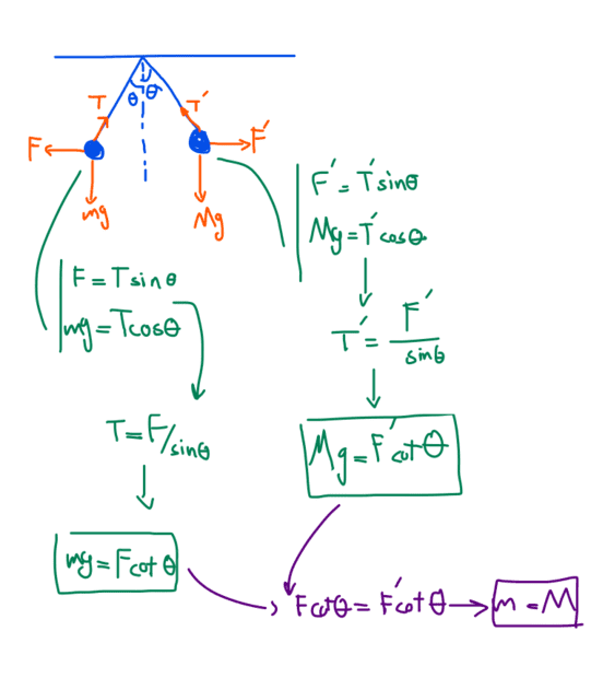

I know that in order for the ropes to have an equal angle as shown in the figure below, the weight of the two balls and the sign of the electric charge must be the same.
But how about the amount of charge?
F=kqQ/(r^2)
I think if we don't consider electron's/proton's mass then we can say that the amount of charge doesn't need to be equal according to Newton's 3rd Law. I mean having q on one ball and 2q on another ball , still makes the angles having the same size. Is it true ?
What if we consider proton's mass(or electron's mass) ???
I think both balls should have same amount of electric charge and number of protons(electrons)on each ball should be equal.
Are you sure about the bold part? I certainly agree that the charges must have the same sign but are you sure there is no way to fiddle the mass/charge ratio so that the weights are not the same?
I think they should have similar mass.
So, you've moved from identical mass to "similar" mass. Even for that, I have to ask ... why?

Hello @MatinSAR. I follow your work shown in green in your figure of post #6. Can you state your reasoning for writing the purple equation ##F \cot \theta = F' \cot \theta##? I think you're probably thinking correctly and you're getting this equation from something you mentioned in your first post. But please confirm how you got the purple equation.
You were also asking whether the two charges had to have the same magnitude. You should be able to answer this by inspecting Coulomb's law.
Hello. Because of Newton's 3rd law F should be equal to F'.

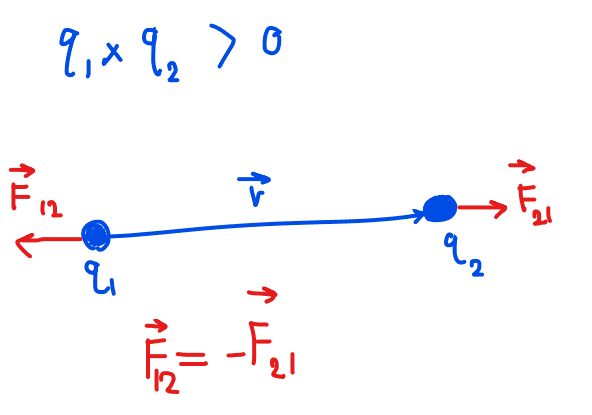

I think it's not necessary because of the fact that F12=F21.
TSny said:
As @.Scott mentioned, changing the charge of a ball does not change the mass of the ball by any significant amount.
So mass of the balls should be the same and the charges should have same sign ...
And it is not necessary to have same amount of charge on each ball.
Is it true?
phinds said:
Which is not necessary for this problem --- that's what I'm trying to get you to see.
Can you tell me why ?!
Here #6 I have proved that the mass of two balls should be equal.(m1= m2)
No, you did not. You proved that if you assume the charges are identical then the masses have to be identical. That is a vacuous truth. Please THINK about the problem. You clearly did not think through post #3.
Yes. The 3rd law is the basis for your purple equation.
OK. But, also, the electric force depends on the charges as the product of the charges. So, the electric force will not change if you change the individual charges such that their product remains the same.
Is it true?
Yes.

TSny said:
Yes. The 3rd law is the basis for your purple equation.OK. But, also, the electric force depends on the charges as the product of the charges. So, the electric force will not change if you change the individual charges such that their product remains the same.Yes.
I have understand it completely.
No, the assumption made in post #6 is that the electrostatic forces are equal and opposite. Seems fair.
