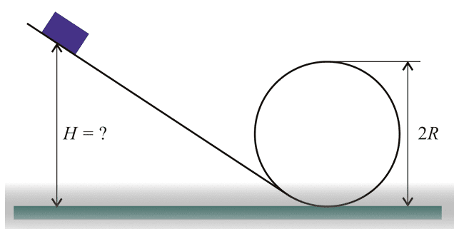

A small ball rolls down a slide to which is attached a devil's loop of radius R. What should be the height of the slide so that the ball falls off at a height of 1.5R?
NA
Hello everyone! I tried to solve this problem in a non-inertial system. Probably I should use the principle of conservation of mechanical energy in the following form
$$mgH = \frac{3mgR}{2} + \frac{mV^2}{2}.$$
So the only thing to do is to compute $V^2$. I tried to find this value using the identity below
$$\frac{mV^2}{R} \sin \alpha = mg,$$
where $\sin \alpha = 0.5$.
I think that the equation for $V$ is wrong. What should it look like?

Thank you all for your comments. To sum up I will add some diagrams to illustrate what I am dealing with. First of all the slope and the loop.

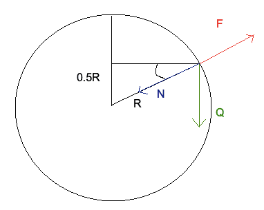

We need to consider the position of our ball at the height of 1.5R. To my mind the distribution of the forces would look as follows
Here Q is the gravity force and F is the centrifugal force. N stands for the pressure which comes from the Newton's third law of dynamics.
It is easy to compute the angle
$$\sin \alpha = \frac{1}{2} \implies \alpha = \frac{\pi}{6}.$$
Calculating the value of H is also quite easy. Using the principle of conservation of mechanical energy we conclude that
$$H = \frac{3}{2}R + \frac{V^2}{2g}.$$
The tricky part for me was to figure out what forces need to be balanced (to compute V); I thought that would be correct
$$\frac{mV^2}{R} = mg \sin \alpha,$$
but after a while I bet it is wrong.

You let @kuruman seduce you to draw the ball as a rectangle :biggrin: !
I don't see any relationships for the ##F##, ##N## and ##Q## in your drawing ?
Your conservation of energy applies where and when ?
Note the hints by @haruspex and @kuruman : at the point of interest, what about radial and tangential accelerations ?
Why do you say that the forces need to be balanced? If they were, the ball would have zero acceleration at the point of interest. To figure out the forces, you first need to ask yourself, "what can conceivably exert a force on the ball?" The answer to that is simple, there is a (assumed frictionless) track and an Earth, nothing else. "Centrifugal force" is not an item that can interact with the ball.
The next thing to decide is the direction of each of the two forces. Everybody knows that gravity is straight down. That would be force labeled "Q" in your drawing. If the track is frictionless, this means that it can only exert a force perpendicular and away from its surface. That would be force labeled "N" in your drawing. That's it. Two items that can exert a force on the ball - two arrows representing these force. Force labeled "F" does not belong. It cannot be the net force because when you add a vector that is "straight down" and a vector that is "down and to the left" there ain't no way you can get a vector that is "up and to the right". You get a vector that is "more down and to the left" which is also the direction of the (non-zero) acceleration.
Proceed from here and write Fnet = ma for the diagram you have with red force F out of the picture. Pay attention to the radial direction.
Yes, that's it. You had the sine on the wrong side previously. I assume you resolved in the vertical direction before, but overlooked that the tangential acceleration has a vertical component. Resolving radially gives your correct version.
