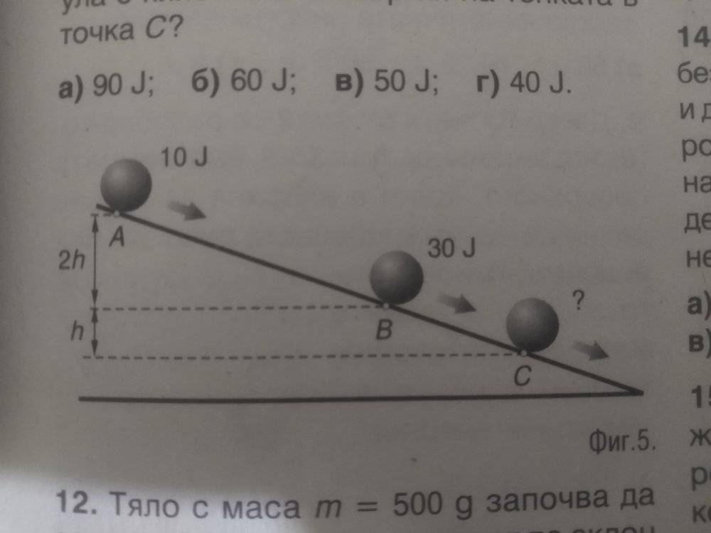

Consider the situation in the attached photo. The kinetic energy in A is 10 J, in B is 30 J. What is the kinetic energy in C?

Using that the mechanical energy is the sum of potential energy ##(E_p=mgh)## and kinetic energy ##(E_k=\dfrac{mv^2}{2})##, we get that the mechanical energies in ##A,B,C## are ##E_A,E_B,E_C##, respectively: $$E_A=10J + mg(3h+h_2)$$ $$E_B=30J + mg(h+h_2)$$ $$E_C=E_{k_c}+mgh_2$$ They must be equal. In other words: $$10J + mg(3h+h_2)=30J + mg(h+h_2)=E_{k_c}+mgh_2$$
Please, post your try, then we will know how to help you.
Good so far. You have a system of equations and unknowns. You only care about finding one of the unknowns. So what do you do next?
Maybe will help you to think about what is the potential energy, and remember that doesn't make sense to talk about absolute potential energy, only its difference is measurable.
