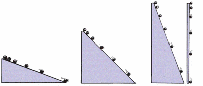

S and a are included in the expression for the time the ball takes to travel the whole distance S, which is
##t=\sqrt (2S/a)##
Then, the time for S/2 is the time used by the ball to cover half the total distance S, which is not 0.5t but 0.71t (the ball moved slower during the first half of the ramp).
Please, note that as the slope of the ramp gets smaller, the acceleration of the ball also decreases, as shown in animation of post #3 above.
That is because the direction of the force making the ball accelerate downhill is parallel to the slope and its magnitude is
##F=mg\sin(angle~of~slope)##
