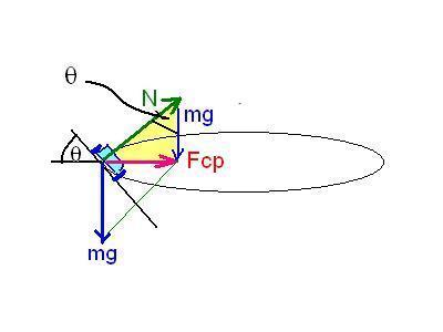

The car is not in equilibrium, but travels along a horizontal circle. Circular motion requires that the forces applied on the car supply the centripetal force. Draw the free-body diagram for the car.

Here is the free-body diagram:
From the yellow triangle you see that the vector sum of N and mg is equal to the centripetal force Fcp.
The weight mg has two components, one normal to the surface, m * g * cosθ, and the other one parallel to the surface, m * g* sinθ...
Yes, but you do not want the car sliding downward, but moving horizontally around a circle.
