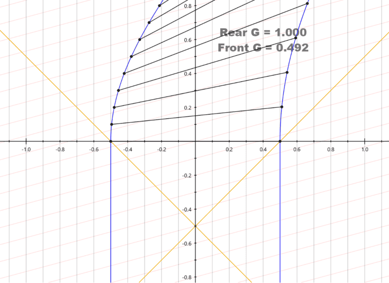

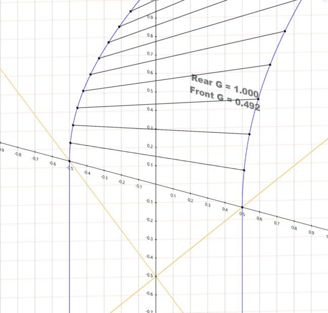

Ok, I think I've got it. To translate everything everyone said to something I could follow, I diagrammed the problem using the normal isotropic convention, then converted this to use a different convention by rotating the X axis by 15 degrees and then skewing the result -15 degrees.
I'm showing the original X axis (now skewed) just to show the X units. The real X axis is now horizontal.
And there we are: the ships, using this convention, do not begin accelerating simultaneously, but the string doesn't break, nor can we use this to determine anything about the 1-way speed of light.

A follow-up question: using the convention above, is there any way to begin the acceleration so that it is considered simultaneous with respect to this convention—and not break the string?
Simultaneously according to what convention?
Since simultaneity conventions keep tripping you up, you really should try to specify your scenario in terms of invariants. For example, how would you launch light signals to get the spaceships to start accelerating as your diagram shows? Your diagram has what I suppose are intended to be light signal worldlines on it, but they don't look like they are traveling on lightlike paths.
How do you know?
You would not be able to use this to determine the one-way speed of light no matter how you have the ships accelerate and whether or not the string breaks. None of those things tell you anything about the one-way speed of light, as has already been posted. There are an infinite number of possible scenarios and picking just one of them, or indeed any finite number of them, and analyzing those can't possibly give you a general conclusion. For a general conclusion you need to grasp the general fact that the one-way speed of light is a convention, not a physical thing.
A simple way to view a standard Minkowski diagram with respect to some other convention is to skew the X axis. The diagram I posted rotated the X axis by 15 degrees. I then skewed the rotated X axis back to its usual horizontal position.
You can approximate the 1-way speed of light in each direction by looking at the grid or you could do the math to calculate it.
When you rotate the X axis and the skew it back horizontal, light paths will look distorted.
PeterDonis said:
How do you know?
This is just a remapping of a diagram in which Born rigidity is maintained. If maintaining Born rigidity keeps the string from breaking, then remapping the coordinates is not going to change anything.
Sorry, I thought you would understand the diagram. If it helps, here is the same thing, with the rotated X axis but unskewed:
Yes, I get that, which is why I asked the people here to help point out the problem in my analysis.
What does the metric look like in your skewed coordinates?
The problem in your analysis is that you are ignoring the fact that changing simultaneity conventions is physically meaningless. If you want a physically different scenario, you need to change something that is physically meaningful. You are confusing yourself because you are thinking in terms of a physically meaningless thing instead of a physically meaningful thing.
