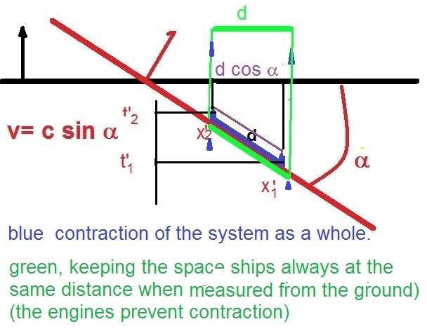

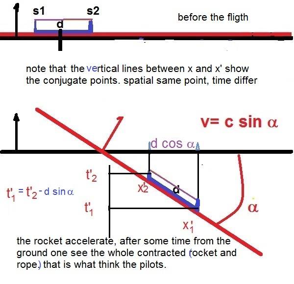

I am trying to explain the paradox with Epstein's diagrams and I have not been able to include figures, that is why I have included a video explaining Epstein's interpretation that allows a better understanding of relativity and its paradoxes. Thank you for your comment

You don't like Epstein's diagrams because you haven't studied them, but I'm sure that if you study them you will appreciate them a lot. You will see a physical model that with some elementary instructions could construct the Lorentz transformations, and also all the strangenesses of relativity are understood geometrically (Euclidean geometry).
I am at your disposal to discuss with you. Riraldi@gmail.com

I will give you a simple explanation, the two rockets leave linked by a rope with equal acceleration, after a certain time the pilots see the rope and there is no reason to see it broken.
Bell says if they have the same acceleration from the ground, they will always be seen at the same distance, but from the ground they should be observed contracted, therefore the motors have supplied the contraction, but the rope does not have motors and if it should look contracted, shorter than the distance between the planes. Then it must have broken.
I will discuss the paradox on my YouTube channel give me a week

I apologize, I am 82 years old and I had not seen Epstein's diagrams until recently, and people tend to think that ignorance itself can be shared.I see that you have more knowledge than I about Epstein's diagrams. especially regarding applications beyond the surface.I have reformed Epstein's theory (and I have managed to elaborate the Lorentz transformations in an elementary way and I am very enthusiastic.If you allow me, I will send you two diagrams by Epstein that illustrate Bell's paradox. At first the acceleration (increase in speed) shows us how the times measured by the pilots are not equal and are calculated with simple trigonometry.In the second, where the planes maintain their distance on the ground, you can clearly see how the rope breaks.It seems very illustrative to me.Apologies again and thank you for your interest.Renato

surely you can prove that it is the expansion factor. But what Bell says is that what is responsible is the possibility of always maintaining the same distance in the ground system despite the contraction observed from the ground.The contraction observed from the ground is an invariant.
There is no "contraction observed from the ground". Observed from the ground, the length of the string between the ships remains constant--it does not contract. In order to even use length contraction in this scenario, you have to talk about abstractions like the "unstressed length" of the string. That's basically what Bell's reasoning did.
However, the expansion scalar is a much more straightforward way of getting to the same conclusion, which does not require inventing anything or talking about "contraction" of a string whose actual length does not contract.
