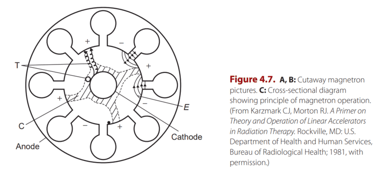

Bent Electrical Field How?
Why is electrical field bent like that rather than following a straight line across to the relevant point over there?
What are the boundary conditions for the electric field at the interface between a conductor and free space?
I don't understand.
