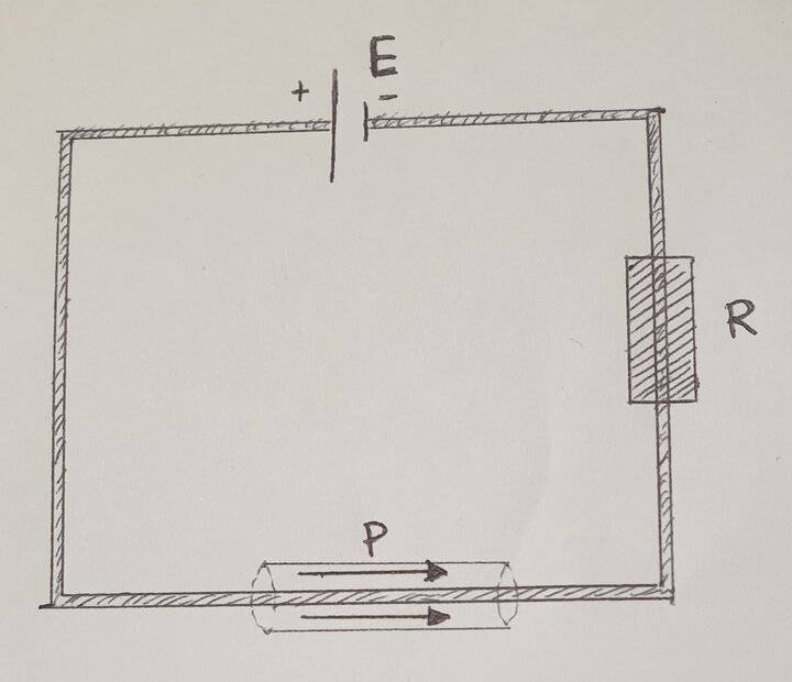

@renormalize this is my diagram. ##\vec P## is the Poynting vector field pointing parallel to the wire's axis.

Sorry I was sloppy. As in the attached diagram, I was considering a cylindrical surface around a wire with bases's width greater than wire cross section. In this case the energy flux integrated over each of the cylinder's bases is not null, however the energy flux entering the right basis is exactly equal to the energy flux coming out from left basis.
Thank you for the diagram.
You may have a misconception regarding the EM Poynting power flow. While it's true that there is some small flow parallel to a perfectly conducting wire just outside it, for separated conductors as you show in your circuit diagram, the vast majority of the power flows well away from the wires directly through space from the battery (power source) to the resistor (power sink). This is evident from a diagram in the thread I referenced above in post #4, which illustrates a 2D model computation of the Poynting flow between a battery and two resistors:
(from Morris & Styer-Visualizing Poynting vector energy flow in electric circuits)
In 3D, the flow field will extend to the exterior of the pair of conductors, but for the usual case of closely-spaced wires, as is typically used for electric power transmission, the bulk of the Poynting flow is concentrated in the gap between the wires. So pairs of wires are to EM power flow much like the inside-surface of a pipe is to fluid flow.
Ah ok, so in that diagram there are not lines of Poynting vector field's flux that enter towards the wire.

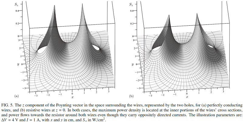

Ok, you mean that the majority of Poynting vector field (hence its flux) is actually "confined/bound" into the external region between the two wires.
Here is an illustration of the actual Poynting vector field arising from direct current flowing in two parallel round wires:
(from Marc Boulé-DC Power Transported by Two Infinite Parallel Wires)
Power flow is overwhelmingly concentrated in the space between the wires, but there is nonetheless some flow above, below, and outside the pair.
Very interesting paper, thanks :wink: . In the conclusion he claims:
Currents and free charges are located on the surfaces of the wires, and because the fields are equal to zero in the perfect conductors, no power flows within them.
I believe the currents he talks about (for perfectly conductive wires) are actually due to the "drift" of free charges over the surfaces of the wires.
