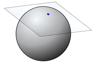

I would like to ask something that I am confused with ,when we talk about a surface its direction is described by the normal to it , so here parallel to the surface does that mean in the direction of one of the vectors in the plane or in the direction of the normal , I assume I should stick to the first definition but I do admit getting confused about what is meant
A curved surface's direction ('orientation' might be a better word) at a point P is the direction of the normal at P.
We can construct the tangent-plane at P. Any line which passes through P and is in this plane is parallel to the surface at P.
https://upload.wikimedia.org/wikipe...t-plane.svg/330px-Image_Tangent-plane.svg.png
If it helps, you can imagine looking at the region near P through an infinitely powerful magnifying glass – the region of the surface near P will look like a flat plane – this is part of P's tangent plane.

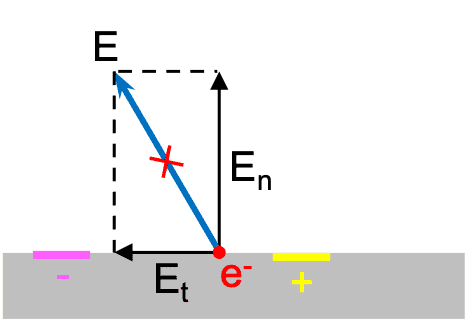

Consider an electron on the surface of the conductor. It is represented by the red dot e-[/color]. Assume that field E (blue arrow) is at an angle away from the surface normal. It can be resolved into a normal component En and a tangential component Et.
The tangential component implies a potential difference across the surface which means a concentration of positive charges to the right of the electron (shown in yellow) and a concentration of negative charges to the left of the electron (shown in magenta.) What will the electron do?
It will migrate to the right and, in so doing, it will diminish the potential difference and hence reduce the tangential component. Other surface electrons will do the same. So the long and short of it is that if there is a tangential component, electrons will migrate and keep on migrating until there have no reason to migrate any more. This will happen when the tangential component of the field becomes zero. Therefore, if there is an electric field at the surface, it can only have a normal component.

thanks a lot for both your time and the visuals , so that means that when I combine the 2 conditions of the electric field being minus the gradient of the potential , with the condition of constant potential inside the conductor it leads me to concluding If there where to be an electric field outside on the surface it must be perpendicular to the surface of the conductor, since if it is not then the potential is not constant meaning the electric field inside can differ from zero which is a contradiction,
