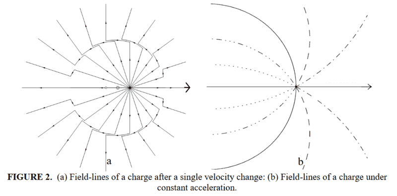

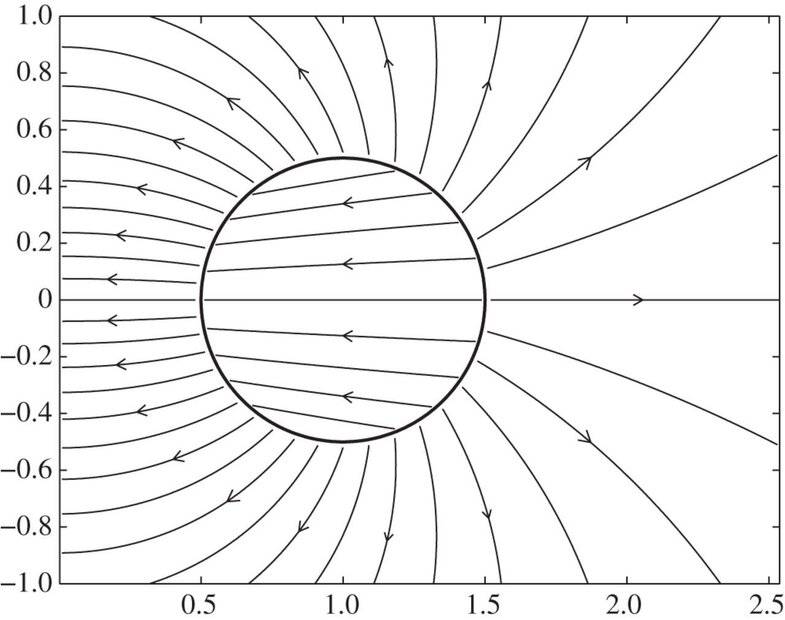

Assuming that a charged spherical shell is moving inertially, would an accelerated observer (test charge) inside of it detect an electric field?
The electric field inside a charged spherical shell moving inertially is, per Gauss's law, zero.
If the spherical shell is accelerated, the field inside is not zero anymore, but it gains a non-null component along the direction of the acceleration, as mentioned, for example, in this paper.
The following picture from the above paper shows the field lines in the xy-plane in the instantaneous rest frame. The shell is undergoing rigid hyperbolic motion along the x-axis (toward the right)
