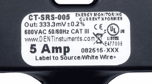

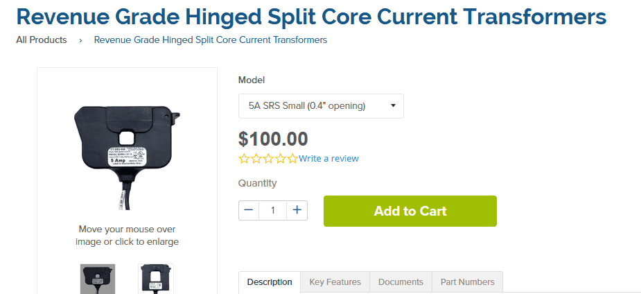

I'm not familiar with that dual current rating, but I'm no expert on CTs either. I use 5A CTs with internal burden resistors in my current metrology work, similar to this one:
https://shop.dentinstruments.com/products/revenue-grade-hinged-split-core-current-transformers
The internal burden resistor assumes that your CT input circuit has a Zin > 10kOhm or so (check the CT datasheet), and a max input Vrms of 333.3mVrms.

Also, how does the CT that I posted above compare to your requirements?
