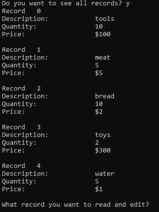

I first run the program to read the invItems as shown here before editing. You can see the 5 records.

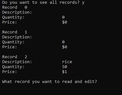

I used all the tools I know how with debugger. It ALL works UNTIL line 108 to line 110. I verify I wrote in the new data in line 103 to 106 that I got the right data written into record. I edited record #2. But after writing, I closed the program and restart the program so I can read back the 5 records, all the other ones got erased as shown.
Console output listing inventory records 0 to 2: records 0 and 1 have blank description, quantity 0 and price $0; record 2 has description rice, quantity 50, price $1, then a prompt asking which record to read and edit.
Like I said, I finally key in the exercise from the book, it did exactly the same thing. In the exercise, they won't know because it only read back the one they changed. As you see, the #2 record I changed is there. Just the rest got erased.
Now I am at a lost, will line 108 to line 110 erase the other record when editing the chosen one? I thought seekp() and write() only write over the one that is pointing and leave the others alone.
Another thing is, I cannot upload the Inventory.dat here, I even change to .txt and still won't work. Another funny thing is If I create the Inventory.dat with another program and just copy into the folder of this program, It WON'T work. Got to create by this program. Don't ask me why. That's why I finally copy 12.20 onto this program from line 1 to line 35. Use it to create the Inventory.dat for the program to use.
I know this is a long program, I exhausted everything I know how to do and I can't fix it. The problem is really in line 108 to 110.

If you were using fopen, I would say you needed to open it with the "r+" flag.
Since you are using fstream:: open, I would try ios::in | ios:: out | ios::binary.
Why using ios::in | ios:: out | ios::binary works?
I did it in ios::in, then I make sure I close the file, then open in ios:: out. Isn't it the same?
I wasted over a day, never think that will make a difference!
Thanks
yungman said:
I did it in ios::in, then I make sure I close the file, then open in ios::out. Isn't it the same?
No. If you open a file for output (i.e., with ios:: out), if it already exists, it will be overwritten.

Yes, it's my fault, I was so sure it doesn't matter and I skipped reading deeper that ios::in | ios::eek:ut is the only way that won't delete the existing content other than the one needs to be changed.
