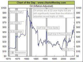

In lieu of your last question, I wanted to be sure to include this.
http://www.oilnergy.com/1obrent.htm#since88
http://www.oilnergy.com/hpix/2obrentm.gif
Oh, I am aware

Chi Meson said:
Oh, I am aware
It is ironic that the aquatic species program concluded when oil was at it's lowest price since the early seventies.
Can't help but add a data point at 2000 - Bush elected.
Although I'd love to blame Cheney & co. for the rise in fuel prices, let's not give any credit to Billy for low gas prices during the 90s--he should have seen what was coming too (there was no secret there in the industry). There was no policy in place to cause the decline in prices through the 90s, and the low prices were responsible for the rational and irrational exuberance of the time.
The real reason for the continual decline in oil/gas prices (adjusted for inflation) from 1980 through 1998, is the opening of the North Sea Oil reserves. Those rigs started running dry a decade ago. Actually, they were running "wet" as the water that was pumped in ( to push the oil up) started coming out with the oil. The availabilty of "friendly oil" has declined along with it. Oil execs recognized this immediately, and looked for more "friendly" oil and found none.
It appears that there was an attempt to create a vast reserve of "friendly oil." The first step? Build a huge Embassy where the largest unexploited known reserve lay. I think that was intended to be the second step, the intended first step being "mission accomplished."
"Oh go F*** yourself." Evidently the Iraqi oil reserves never occurred to the V.P., the P., and the soon-to-be S. of S. (all of them former Oil execs).
It is rumored that water is coming out of some of the Saudi rigs. The Saudis will never admit it, because that would be the end of their power. This is one reason why the reserves might be vastly overestimated in that region.
One more thing. Thank you Reagan, for using the cheap friendly oil to essentially destroy all research in alternative energy. I blame you Ronnie. But then again, Billy didn't help as much as (ironically) W did with the 2005 energy policy.
