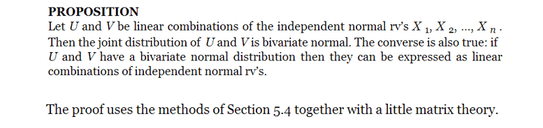

Printed text stating a proposition: if U and V are linear combinations of independent normal random variables X1, X2, ..., Xn, then their joint distribution is bivariate normal, and the converse also holds. A note says the proof uses the methods of Section 5.4 with some matrix theory.
I can't prove this proposition. I have however managed to prove that the linear combinations of the independent normal rv's are also normal by looking at it's mgf
$$E(e^{X_1+X_2+...+X_n})=E(e^{X_1})E(e^{X_2})...E(e^{X_n})$$
The mgf of a normal distribution is $$e^{\mu t}e^{\frac{t^2 \sigma^2}{2}}$$
$$E(e^{X_1+X_2+...+X_n})=e^{\mu_1 t}e^{\frac{t^2 \sigma_1^2}{2}}e^{\mu_2 t}e^{\frac{t^2 \sigma_2^2}{2}}...e^{\mu_n t}e^{\frac{t^2 \sigma_n^2}{2}}=e^{(\mu_1+\mu_2+...\mu_n) t}e^{\frac{t^2 (\sigma_1^2+\sigma_2^2+...+\sigma_n^2)}{2}}$$
Which is the normal distribution with mean $$\mu_1+\mu_2+...\mu_n$$ and variance $$\sigma_1^2+\sigma_2^2+...+\sigma_n^2$$
I know about the theory in section 5.4. Some of it is presented here
$$g(y_1,y_2)=f(x_1,x_2)|\frac{\partial(x_1,x_2)}{\partial(y_1,y_2)}|$$Can anyone show how the proof they refer to by section 5.4 and matrix theory goes?

I think you are looking at the wrong problem. The description implies that
\begin{array}{rcl}
U&=& a_1 X_1 + a_2 X_2 + \cdots + a_n X_n \\
V&=& b_1 X_1 + b_2 X_2 + \cdots + b_n X_n
\end{array}
Here the ##a_i## and ##b_i## are constants.
You can work out ##EU, EV, \text{Var}(U), \text{Var}(V)## and ##\text{Cov}(U,V)## in terms of the ##a_i, b_i## and the original ##\mu, \sigma## of the ##X_i##. Thus, you have a formula for the means and variance-covariance matrix in terms of ##a_i , b_i, i=1,2,\ldots, n##.
I think that what the question is asking for is the converse: given ##\mu, \sigma##, the means and the variance-covariance matrix of ##U,V##, it wants you to either find appropriate ##a_i, b_i## that will work (that is, give the right ##U,V##), or at least to show that such ##a_i, b_i## exist, even if not easy to find. Using moment-generating functions (as you did above) should be very helpful for this purpose.

I won't give a lot of details, but will expand a bit on my previous post.
Presumably, if you are given the means ##EU, EV## and the variance-covariance matrix of the pair ##(U,V)##, you are allowed to specify just how to make up ##U,V## in terms of some iid random variables ##X_1, X_2, \ldots, X_n##. That is, we are allowed to choose an ##n## in an attempt to prove the result.
When we are given the above information about ##U## and ##V##, we are given five items of data: two means, two variances, and one covariance. So, we will need at least five "coefficients" altogether.
I tried ##U = a_1 X_1 + a_2 X_2## and ##V = b_1 X_1 + b_2 X_2 + b_3 X_3##. The means, variances and covariance of ##(U,V)## can be expressed algebraically in terms of the ##a_i, b_j## and the underlying ##\mu, \sigma## of the ##X_k.## Thus, we obtain five equations in the five variables ##a_1, a_2, b_1, b_2,b_3##.
I managed to get a solution, thus proving the result asked for; however, it would possibly take many hours (perhaps days) of algebraic work to do it manually, so I saved myself a lot of grief by using the computer algebra package Maple to do the heavy lifting.
I don't see how matrix properties would be useful here, but maybe the person setting the problem had another method in mind.
