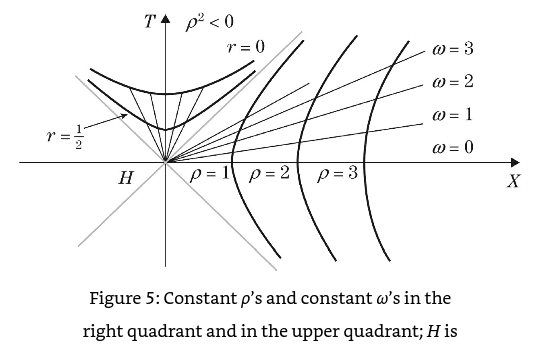

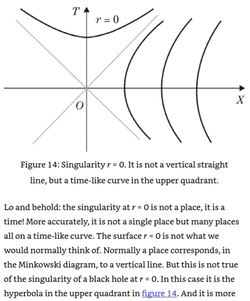

In "General Relativity: The Theoretical Minimum" (Susskind, Leonard; Cabannes, André), the surface corresponding to the black hole singularity is described as time-like. Why?
Below is the description from the book. I thought that hyperbolas in the right quadrant are time-like and hyperbolas in the upper quadrant are space-like. If it were so, the surface ##r=0## would be space-like, but the book says otherwise. -- ?
You are correct. The singularity in a Schwarzschild black hole, which is what the diagram is showing, is spacelike. That is a huge error, which I am extremely surprised to see in that book.
I guess Susskind needs to read Wald, section 6.4, which explicitly states what I state in the quote above.
On a Kruskal diagram, like on a Minkowski diagram, null lines slope at 45° and timelike lines are steeper than that.
The body text correctly notes that the singularity is more like a time than a place, though, meaning it is spacelike (any "now" must be a spacelike surface - or line in the case of the Schwarzschild singularity). So the caption is a typo that's got past the authors and editors.
At least two of them, since "time-like" appears in both the Figure label and the paragraph of text beneath it.
In other words, the hypersurfaces ##r=\text{const}## with ##r<r_{\text{S}}## are spacelike since the corresponding ##r##-lines are "normal vectors" of this hypersurface are time-like. It's often confusing, but one has to remember that a hypersurface is spacelike if the normalvector is timelike and vice versa. So I'd also say the singularity ##r=0## is a spacelike hypersurface rather than calling it time-like.
May be they meant to say that it is like a moment of time. Many places at the same time.
The text sort of says that, but the correct term for such a surface is "spacelike"--it's a surface that can be viewed as "space"--many places--at an instant of time.
Hmm... The book insists: 20 pages later, referring to this figure,
it says,
If by "upper quadrant" they mean the black hole region, this is of course wrong. The constant ##t## lines in the black hole region are timelike, and the constant ##r## hyperbolas are spacelike.
I am skeptical that these were typos. Based on my previous experience reading papers by Susskind, I suspect he is making up his own terminology (where "space-like" means "like a point in space" and "time-like" means "like an instant of time") and either hasn't bothered to check the literature, or doesn't think it matters. Which, given that this book is supposed to be for pedagogy, does not strike me as a sound strategy. I hope I'm wrong.
They do.
