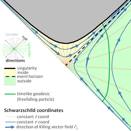

  • #153
TrickyDicky said:
Yes, and it's a Killing vector field too, as long as Birkhoff's theorem holds.
No, it isn't. A Killing vector field is a vector field along whose integral curves the local metric is unchanged. The local metric is not unchanged along the worldline of an infalling observer, since the metric coefficients are a function of r; only a curve with constant r can be the integral curve of a Killing vector field in Schwarzschild spacetime.
TrickyDicky said:
According to Birkhoff's theorem a spherically symmetric vacuum has a timelike ∂t Killing vector field, in this context, the integral curves of this KVF are timelike geodesics.
No, this is false. The integral curves of ∂t are timelike *curves*, but they are *not* timelike *geodesics*. The proper acceleration along such curves is nonzero.
TrickyDicky said:
Your example is of an ingoing geodesic, so I don't understand what you mean by "are not geodesics".
The example I gave was for the worldline of a radial freely falling observer, which is indeed a geodesic, but it is *not* the integral curve of a Killing vector field. Conversely, the integral curves of ∂t *are* integral curves of a Killing vector field, but they are not geodesics. See above.
TrickyDicky said:
You said in the other thread " the event horizon is the boundary of the region in which the Killing vector field of the "time translation" isometry of Schwarzschild spacetime is timelike--i.e., the EH is the Killing horizon associated with the "time translation" isometry."
Yes, that's true.
TrickyDicky said:
But then how is this compatible with the fact that spherically symmetric vacuums have timelike Killing vector fields (or to use Carroll's words in his Notes on GR: "We have therefore proven a crucial result: any spherically symmetric vacuum metric possesses a timelike Killing vector"), the logical question here would be then, is the region inside the EH (region II) a vacuum or not? If it is it must have ∂t KVF and therefore your EH definition would not be valid.
Ah, perhaps this is the source of the confusion. The vector field ∂t is a KVF everywhere in the spacetime; this can be shown easily from Killing's equation. But ∂t is only timelike outside the EH; it is null on the EH and spacelike inside it. And the region inside the EH is certainly a vacuum everywhere (at least, it is in the maximally extended Schwarzschild spacetime). So I think Carroll left out a qualifier in his statement of the "crucial result"; he should have said that any spherically symmetric vacuum metric possesses a Killing vector field that is timelike *within the region where the spacetime is static*.
I haven't got time to dig into Carroll's notes right now, and I can't remember how much detail he gives about the derivation of Birkhoff's theorem. But as I understand it, spherical symmetry plus vacuum is enough to show that (1) there must be a static region of the spacetime; (2) there must be a Killing vector field on the spacetime which is timelike within that static region; and (3) the static region must be asymptotically flat (i.e., the metric goes to Minkowski as r -> infinity, so the static region must include r -> infinity). But those three things together do not require that the static region cover the entire manifold: and if there is a Killing horizon associated with the Killing vector field, then the static region will *not* cover the entire manifold.
  • #154
But they are not a function of t, and I was referring to a timelike KVF, not a spacelike one that is what you are talking about here.
In the general case that is usually true, but we are talking about free-falling towards the singularity thru the EH in a spherically symmetric vacuum, not about hovering observers.
It is indeed a timelike geodesic and its time-symmetry is derived by being an integral curve of a time-symmetric Killing vector field.
Indeed there is confusion about this point but I'm not so sure is on my part.
A killing vector field that is timelike:∂/∂t, generates a time-symmetry, if you say that such a KVF is everywhere in the spacetime you are agreeing with me. If in the next phrase you say that a timelike (∂/∂t) killing vector field is only timelike outside the EH you are contradicting yourself. What I mean is that if they are timelike they cannot be spacelike and viceversa. Probably what you want to say is that the Killing vector field(without qualifiers,not the timelike KVF) is spacelike inside the EH, null at the EH and timelike outside the EH. And this is what is IMO incompatible with the maximally extended Schwarzschild spacetime being a spherically vacuum solution.
If you define the region inside the EH as a region free of timelike KVF then I don't see how that region can be a vacuum, we know the Birkhoff theorem states that a spherically symmetric vacuum must be static, and the region inside the EH is certainly not static.
Thus my question. According to wikipedia Birkhoff's theorem states that any spherically symmetric solution of the vacuum field equations must be static and asymptotically flat. I would say this implies that where it is not static it is no vacuum solution.
No, it is *not*. The worldlines of radial freely falling observers are *not* integral curves of any Killing vector field. Why do you think they are?
Just for explicitness, the only Killing vector fields in Schwarzschild spacetime are: ∂/∂t, ∂/∂theta, ∂/∂phi, and linear combinations of those with constant coefficients. The only one of those which is timelike in any portion of the spacetime is ∂/∂t.
A KVF *always* generates a symmetry; that's the definition of a KVF. Whether the integral curves of that KVF are timelike, spacelike, or null can vary from one integral curve to another; being timelike, spacelike, or null is not an intrinsic property of the KVF that has to be the same everywhere. So a KVF only generates a "time-symmetry" in regions where it is timelike.
I see that in one particular spot I did say the integral curves of ∂/∂t were timelike curves (but not timelike geodesics), but I only meant "timelike outside the EH". I should have said that explicitly, I suppose, but even from the context it should have been clear that that's what I meant (since I explicitly stated at the end of the same post that ∂/∂t was only timelike outside the horizon). In any case, I agree with the quoted statement just above (since it's the same thing I said at the end of that post).
Again, I think there should be a qualifier: instead of "static" it should say "asymptotically static" or something like that. As I said at the end of my last post, I believe that strictly speaking, Birkhoff's theorem only shows that there must be a static *region* in a spherically symmetric vacuum spacetime, and that region must be asymptotically flat; I do not believe Birkhoff's theorem shows that that static region must cover the entire manifold. However, I'm not able to look up specific references right now that state the actual assumptions and steps of the proof.

  • #160
DaleSpam said:
And none of the integral curves of those Killing vector fields are geodesics except at spatial infinity. But I thought that there were 4 Killing vector fields.
There are; I forgot to list one of the three that are symmetries of the 2-sphere. See the asterisk in my response to TrickyDicky just now.
  • #161
The free-falling observer does indeed follow a geodesic, but that geodesic is NOT an integral curve of the Killing vector field.
The curve corresponding to the time-like Killing vector is the worldline of someone hovering at a constant r, theta, phi in Schwarzschild coordinates, not someone freefalling.
