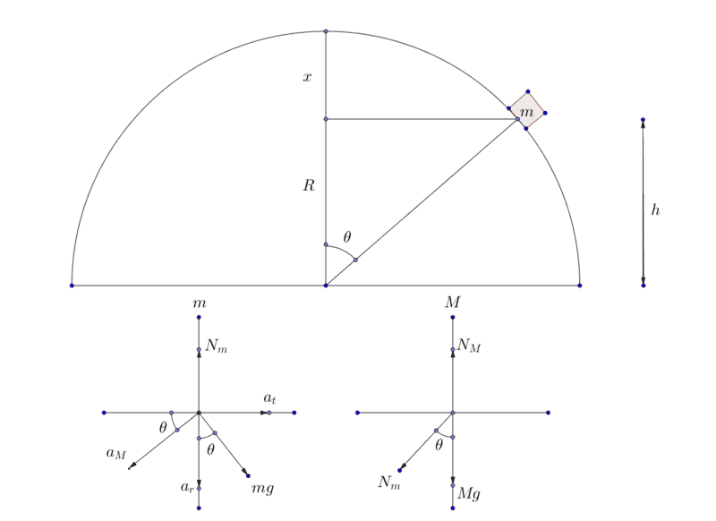

A block of mass m slides down a hemisphere of mass M. What are the accelerations of each mass? Assume friction is negligible.
(See attatchment)
a_M = Acceleration of hemisphere
N_m = Normal force of M onto m
N_M = Normal force of ground onto M
\sum \text{F}_x = ma
So from the FBD's, I come up with
\sum \text{F}_{xm}= mg\sin \theta = m(a_t - a_M \cos \theta)
\sum \text{F}_{ym} = N_m - mg \cos \theta = -m(a_r + a_M \sin \theta)
\sum \text{F}_{xM} = -N_m \sin \theta = Ma_MI need another equation, so I tried going the route of work-energy, to find the tangential speed of the block sliding on the hemisphere, but can I look at the energy of the block by itself? I figure I cannot, as it is atop an accelerating body.
If I can consider the energy of the block by itself to find the tangential speed, then I can solve for aM,
$$ a_M = gm\sin \theta \frac{2-3\cos \theta}{M-m\sin ^2 \theta} $$
which goes to 0 when M >> m and so then a_t = g\sin \theta in that case which checks out, however I am still a little weary about this.
I'm rather stuck here so any help would be appreciated.
