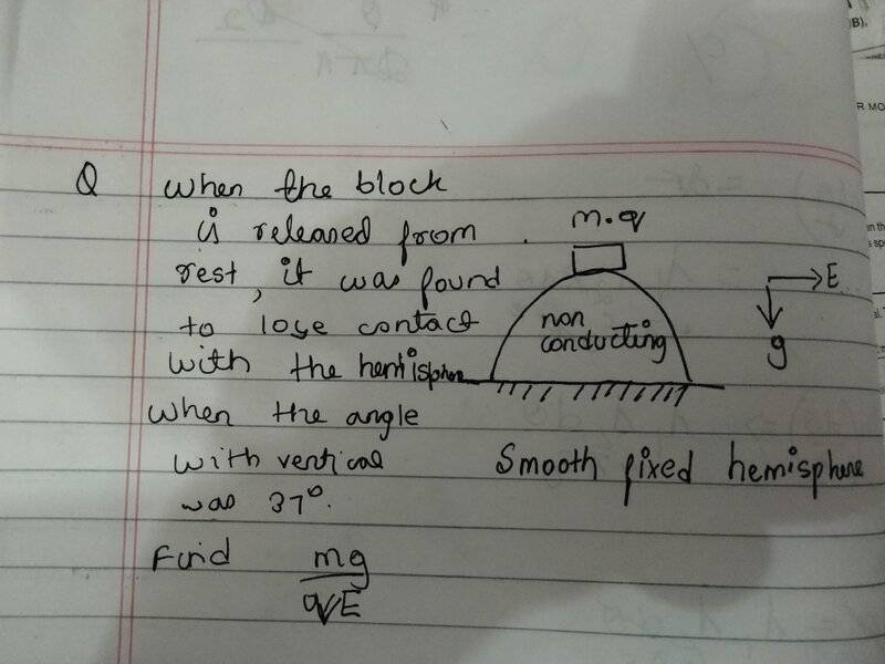

A block of charge q and mass m is kept on a smooth non conducting hemisphere . When it was released from rest it was found to lose contact either the hemisphere when the angle with the vertical was 37°. find mg/qE
The electric field is perpendicular to the gravity

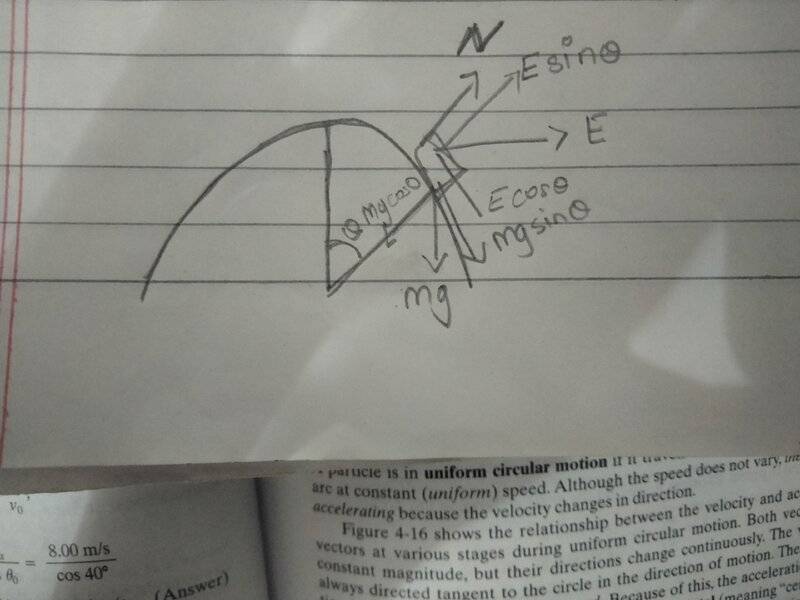

Firstly I drew the FBD of the said block at an angle theta from the vertical
Which force causes the block to lose contact.ie the normal to become zero...
Is it because the forces in the horizontal direction surpass some limit value of the net force in the radial direction...? I find this very confusing
I understand that the net force in the vertical direction would not be equal to zero when the block is in contact with the hemisphere....if it were 0 then the block would move in a straight line tangent to any point on the hemisphere....This net force is centripetal Force
Mathematically when the normal force equals zero the sum of the vertical forces would equal to the centripetal force..
But physically I cannot visualise it...its all very confusing... Is there a way I can back tract from the last equation, sum of vertical forces equals the net force m×a and find out a to be v²/r......?

After reading the roblem more carefully, it seems that the block is charged. It makes sense because the angle would not be 37° if gravity and the normal force were the only forces. Please provide the exact statement of the problem as was given to you.
tellmesomething said:
But why is it losing contact is it because a force in the perpendicular direction increases? causing the resultant vector to move out of the trajectory of the circle say a non uniform circular motion?
You should be able to see that if you draw a FBD diagram, find an expression for the normal force and see what must be true for it to be zero.

Yes sorry my bad
For the normal force I get this expression mgcostheta - E sin theta - mv²/r = N
But I dont understand how this tells me anything...I only get that the sum of the vertical forces equal the centripetal force when normal becomes 0

First of all, the sum of all the vertical forces can only be a force along the vertical, in the direction of (or opposite to) the acceleration of gravity. The centripetal force by definition points towards the center of the hemisphere. You can only set the sum of the vertical forces equal to the centripetal force when the block sits at the very top of the hemisphere.
Secondly, you will need to find ##mv^2## assuming that the block starts from rest at the top of the hemisphere. That's an assumption that I have to make because you still have not provided a statement of the problem. How do you think you can find ##mv^2~##?

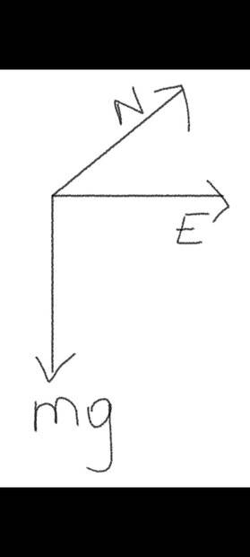

The electrostatic force appears not to have a vertical component from the looks of your drawing. You probably meant the sum of the weight and the electrostatic force. The centripetal force then would be the vector sum of (a) the weight, (b) the electrostatic force and (c) the normal force. Can you find an expression for that?
I dont understand what you're asking...? How can sum of weight and electrostatic force and normal be centripetal force.....
It is the sum of the vertical component of weight,electrostatic force and normal force which is equal to the centripetal force... Vertical component as in E sin theta and mg cos theta..
The expression being mg cos theta - E sin theta - N = mv²/r
Edit : I just noticed that you said vector sum..sorry producing another expression...
Wait doss that mean the net force is centripetal force.....? Tht doesnt make quite sense...that would
That wouldn't make quite sense... If I add these vectorially the resultant would not be in the direction of centripetal force

No, that's OK. It's the component in the centripetal direction that counts in this case.
This is incorrect. Check the electrical force.
No. It would be in the direction of the net force. There is also a tangential component. You need to concentrate on the centripetal component because that's where the normal force appears.
So how are you going to find ##mv^2~##?

Oh sorry It should be E q sin theta
For mv² I would have to find the velocity at the point when it loses contact I can technically find the displacement but im contemplating whether the net acceleration is constant for using the SUVAT equations..

QE R sin theta+ mg (R- R cos theta) = 1/2 mv²-0

You don't need to go there. You have
and you have
What must be true for N to be equal to zero when θ = 37° ?

Mg cos theta - E sin theta = mv²/r
Probably need to divide these two equations

I would take ##mv^2## from the work-energy equation and put it in the centripetal equation.
There is no alternate solution. Writing the work-energy energy equation is the way to approach this problem. Don't forget that the acceleration is a function of θ and θ is a function of t. You can say "I can integrate", but if want to find the velocity, you need to do an integral of the form $$v(t)=\int a(\theta(t))dt.$$Good luck with that.
