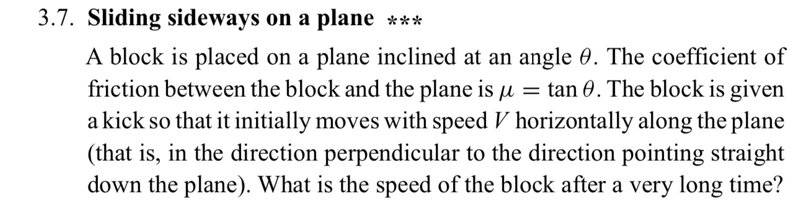

TL;DR Summary: In Morin 3.7 sliding sideways on a plane I used a completely different method than he did and got the correct answer is my method right
The problem statement is as follows
I split up the friction force into x and y components derived a diff eq for v_y in terms of v_x then took the limit as v_x goes to 0
My solution was this

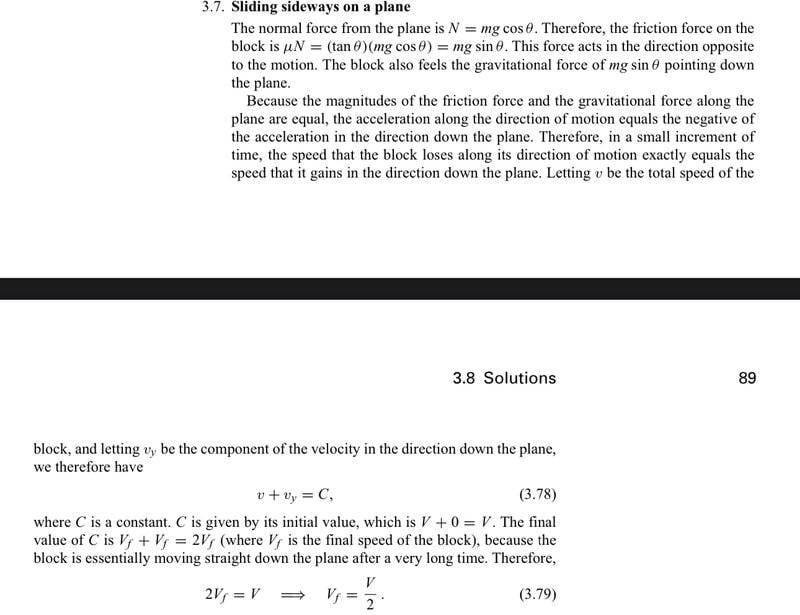

This is the book’s solution

Unfortunately, that does not give the right answer if you plug in ##v_x=0##.

If ## \frac {dv_y}{dv_x} = \frac {v_x}{V} ## is true, from here it can be get that ## v_y = \frac {v_x^2}{2V} - \frac {V}{2} ##. For ## v_x=0 ## ## v_y ## will be ## -\frac {V}{2} ##.
