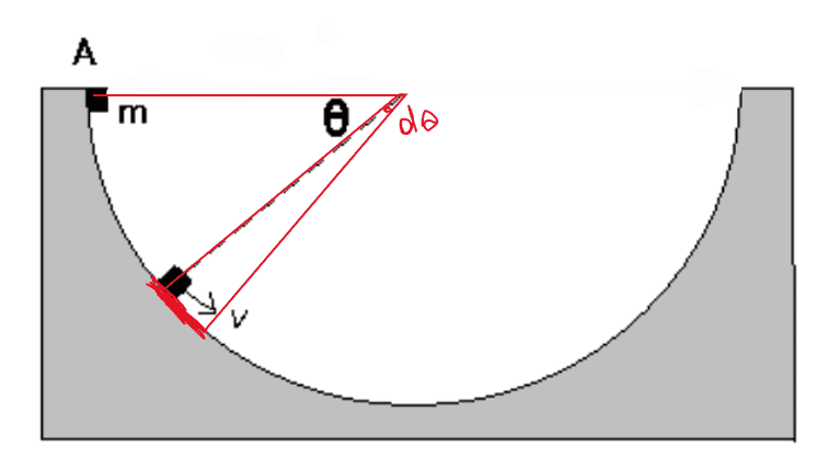

A block of mass m rests at point A on a circular track of radius r with coefficient of friction u. It is then released with no initial speed. Find the dependance of velocity on angle, v(theta).

Since the friction is constantly changing because of both angle change and velocity change, I took a very small angle dθ, so that while the block is covering it, its velocity would change by dv, its height by rdθ*cosθ and the friction force wouldn't change much, because N isn't changing either.

Then, I wrote the equation for centripetal force:
N - mgsin(θ) =

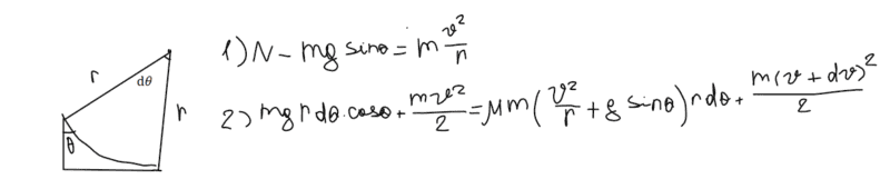

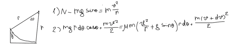

Next, I thought of writing conservation of energy for this small displacement:
Potential energy + Kinetic energy = Work by friction on this small displacement + Kinetic Energy after.
So I got this:
Handwritten diagram of a block on a circular arc of radius r, with angle dθ and angle θ marked, and two handwritten equations: N - mg sinθ = m v²/r, and mgr dθ cosθ + m v²/2 = μ m (v²/r + g sinθ) r dθ + m(v + dv)²/2.
And I am not sure if this is right, because I end up getting an equation with differentials left, and it doesn't make sense. Could someone help, please?

zuzelle said:
Okay
Maybe dont work with the differentials in Work-Energy right away. Write Work-Energy in the standard way and differentiate w.r.t. ##\theta##. So you will have your normal terms plus an integral ( representing the work done by the friction force up to some angle ##\theta## ) in the first step. Then that result will be differentiated w.r.t ##\theta## to get the first order-nonlinear ODE.
I think it can be transformed into a linear ODE from there with a standard substition technique and solved with integration factor technique.
Excuse me for asking again, like this?
  • Equation: mgr = mgr(1 - sin θ) + mv²/2 + μm ∫ from 0 to θ of (g sin θ + v²/r) r dθ
  • Equation: g r sin θ + μ g r cos θ = v^2/2 + integral from 0 to θ of v^2 dθ, written in handwritten-style typeset math.
Start with ##~N=mg\sin\theta +m\omega^2r.~## Using ##\omega## is preferable because linear variables (##v##) and angular variables (##\theta##) are not mixed. The force of friction is
##f_k=\mu(mg\sin\theta +m\omega^2r)## and the Newton's second law in the tangential direction of motion is
##ma_t=mr\dfrac{d\omega}{dt}=mg\cos\theta-\mu(mg\sin\theta +m\omega^2r).##

##\dfrac{d\omega}{dt}=\dfrac{d\omega}{d\theta}\dfrac{d\theta}{dt}=\omega\dfrac{d\omega}{d\theta}## Now you see the reason for ditching variable ##v##. The differential equation you have to solve is $$m\omega\dfrac{d\omega}{d\theta}=mg\cos\theta-\mu(mg\sin\theta +m\omega^2r).$$ It should give you ##\omega(\theta)## from which getting ##v(\theta)## is trivial since ##r## is constant.
Your equation on the left becomes:
$$ 0 = -mgr \sin \theta + \frac{1}{2}m v^2 + \mu m r \int \left( \frac{v^2}{r} + g \sin \theta \right) d\theta $$
Now differentiate both sides with respect to ##\theta##.
EDIT: Going from Newtons Laws obviously works too (also more direct) as @kuruman showed.
Also, so we can quote your equations that follow, please take a moment to learn the math formatting from LaTeX Guide
##ma_t=mr\dfrac{d\omega}{dt}=mg\sin\theta-\mu(mg\sin\theta +m\omega^2r).##
Check the first term on the right side. I don't think ##\sin \theta## is the correct trig function here. For example, ##a_t## should equal ##g## at the starting point where ##\theta = 0## and ##\omega = 0##.
Yes. One cannot have the same trig function of ##\theta## for ##N## and ##a_t## which are orthogonal. Nice catch. Typo fixed - thanks.
