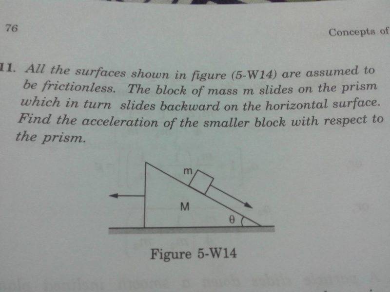

All the surfaces shown in fig. are assumed to be frictionless. The block of mass m slides on the prism of mass M which in turn slides backwards on horizontal surface with acceleration of ao. Find the acceleration of smaller block with respect to prism.
As we are working from the frame of reference of prism which is non inertial
we have to include a pseudo force in opp. direction of acc of prism.
Now , forces on the block are
1)mg downwards
2)Normal force N
3)pseudo force (mao)
When I resolved these forces using force body diagram , it gave me 2 equations
maocosθ+mgsinθ=ma
i.e aocosθ+gsinθ=a
and
N+maosinθ=mgcosθ
I m stuck here...
How to eliminate N and ao ??
Please help
Ans is
(M+m)gsinθ / M + msin2θ

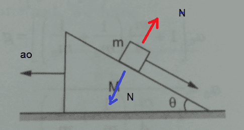

The block and the prism interact with the normal force of magnitude N. See picture. If ##\vec N## is the normal force acting on the block, then it is ##-\vec N## acting on the prism.
The normal force exerted on the prism has a backward component, accelerating the prism horizontally, to the left. @Prathamesh was right.

if a0 is taken as +ve directed on the right side , then naturally
-Ma0 can be seen as vector going to the left.
The force causing this acceleration of the block is -N. -Mao=-Nsin(theta), and you can eliminate the minuses.
