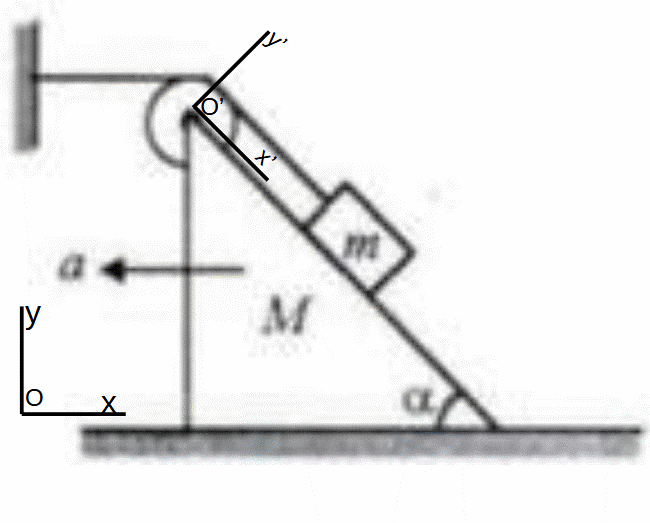

We have a block on a wedge, connected to a string which is fixed on a vertical wall to the left of the wedge.The string is horizontal and taut.
The wedge has an acceleration a towards the right. Mass of block is m.
Find the acceleration of the block
i) Relative to the ground
ii) Relative to the block
There is no friction anywhere.
Acceleration a along the incline
T - mg = ma
Acceleration along the normal to the incline
mgcosø - N = masinø
So I basically identified two constraints,
1) The string cannot be slack, therefore the acceleration of block down the incline should be equal to the acceleration of the wedge.
2) The block must always stay in contact with the wedge. Hence, the acceleration of the block normal to incline must be equal to the component of the wedge's acceleration along that directi
on.
The answer is given as option A which is absolutely not what I'm getting.
Also Acceleration of block w.r.t ground is given as 2aSinα/2, which is option (B) multiplied by a factor of 2; how did this come about?
So what what am I missing here ?
Is there anything wrong with my inference?

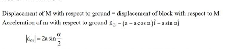

Here is the given solution :
I do not understand the solution at all as I'm still a bit confused about relative motion in such problems.
Any insight into analysing such situations is deeply appreciated

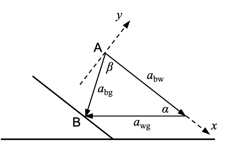

I think the original question is badly written. References to ‘acceleration’ are really references to the magnitude of acceleration. The symbol ‘a’ should really be ‘|a|’.
The string has a horizontal part (length ##p##) and a sloping part (length ##q##). ##\Delta p = -\Delta q ##. It follows that ##\frac {dp}{dt} = - \frac {dq}{dt}## and ##\frac {d^2p}{dt^2} = - \frac {d^2q}{dt^2}##.
The magnitude of the wedge’s acceleration relative to the ground is ##|\frac {d^2p}{dt^2}|##.
The magnitude of the block’s acceleration relative to the wedge is ##|\frac {d^2q}{dt^2}|##.
So these 2 magnitudes are equal (answer A).

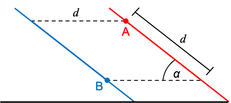

That said, there is a simple way to get a handle on this. Note that if the wedge ##M## moves to the left by distance ##d##, the piece to the left of the pulley is shortened by ##d## which means that mass ##m## moves down the incline also by distance ##d##. The figure on the right shows the initial and final positions of mass ##m## at points A and B respectively.
Hint (on edit): In the accelerating frame of the wedge, the block travels distance ##d## under constant acceleration of magnitude ##a## in time ##T##. In the inertial frame of the ground, the block travels distance AB under constant acceleration of magnitude ##a_G## also in time ##T##. Some trigonometry is needed.

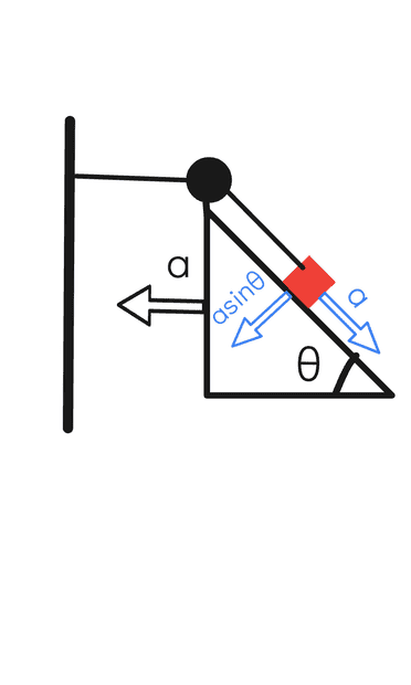

So when I first tried to solve this question, this is the FBD i came up with :
I simply applied the constraints I already mentioned.
In the frame of the wedge, there would be a rightward pseudoforce on the block.
The component of this force normal to plane will balance the masinø shown in the diagram,
The component of this force parallel to the plane will get added with the existing acceleration a.
Thus,
Net acc normal to incline = 0
Net acc parallel to incline = a + acosø
I know this is wrong, I would be grateful if you could point out why I'm wrong and explain how to deal with such cases.
Thanks in advance!

Because the wedge is accelerating, it's tricky to calculate the contact force between the block and the wedge. This should be an unknown in your FBD. You could use the observation about the fixed length of the string in order to calculate this contact normal force- eventually.
As has already been pointed out the constraint of the string is the fundamental factor. If the wedge moves a distance ##d## to the left, then the pulley moves by a distance ##d## to the left, releasing string of length ##d##, so that the mass ##m## slides a distance ##d## down the block - and, as it's constrainted to remain on the block(*), this must be relative to the block.
The displacement of ##m## relative to the ground is the vector sum of ##d## horizontally left, plus ##d## at an angle ##\pi - \theta##. You can see this by imaginging that the wedge moves first and then the mass moves relative to the wedge.
This gives a total displacement of ##d(1 - \cos \theta, sin \theta)## relative to the ground (with left and down being positive). The magnitude of this is ##2d\sin \frac \theta 2##, as per the answer key.
Differentiating twice wrt time gives the same equations for acceleration. You can then use the acceleration in the ground frame to calculate the contact force and complete your FBD.
(*) this constraint may be worth thinking about!

Why do you think the acceleration to the block normal to the incline (in the ground frame I suppose) would be ##a\sin\alpha##? It is not correct. In the frame of the wedge this acceleration is zero because otherwise the block would either enter the wedge or lose contact.
In the wedge frame, it should be clear (as I stated and @PeroK detailed further) that acceleration is parallel to the wedge and has magnitude ##a##. The acceleration in the ground frame is the vector sum of that acceleration and the acceleration of the wedge, ie, an isosceles triangle with apex angle ##\alpha##. Its magnitude ##a’##, by elementary geometry, is therefore given by the cosine theorem:
a’^2 = a^2 + a^2 - 2a^2 \cos(\alpha) = 2a^2[1-\cos(\alpha)]
or, taking the square root,
a’ = 2a\sin(\alpha/2).
The direction of the acceleration relative to the ground makes an angle ##\alpha/2## to the vertical. All of this can be deduced from the geometric constraints only. No force analysis is necessary.
Edit: The above also explains OP's question regarding why the (magnitude of) acceleration relative to the ground is twice ##a\sin(\alpha/2)##.
Edit 2: Fixed a factor of 2 in the angle to the vertical.

I thought that,
Say the wedge moves a distance x to the left. Now for the block to stay in contact with the wedge it must move a distance xsinø in the direction normal to the plane.
Thus double differentiating w.r.t to time
You can say that the acceleration will be equal to asinø
Why is this inference wrong?

In this case, say if the wedge has a horizontal acceleration A to the left,
Then the block must have an acceleration Asinø in the direction normal to the plane.

You may already have cleared-up any confusion, but in case not (and since it's quite important)...
The xy coordinate system is fixed to the ground with the x-axis horizontal; observer O is at its origin.
The x’y’ coordinate system is fixed to the wedge (at the wheel’s pivot) with the x’-axis parallel to the slope; observer O’ is at its origin
Measurements of displacement, velocity and acceleration made by O (in terms of xy values) are said to be ‘relative to the ground’ because O is ‘fixed’ to the ground.
Measurements of displacement, velocity and acceleration made by O’ (in terms of x’y’ values) are said to be ‘relative to the wedge’ because O’ is ‘fixed’ to the wedge.
For example, if the wedge moves 1m left, the x-coordinate of the wedge has decreased by 1m. The displacement of the wedge relative to the ground (relative to O) is 1m left (say from, x=10m to x = 9m).
In this case, because the rope’s length is fixed, the block moves 1m along the slope. The displacement of the block relative to the wedge (relative to O’) is 1m downhill (say from x’=2m to x’=3m).
The two displacements (wedge-relative-to ground and block-relative-to-wedge) have equal magnitudes (although their directions are different). Similar reasoning applies to the magnitudes of the two velocities and the two accelerations.
First of all, A HUGE Thank you to you and everyone in this thread.
Your way of reasoning with the coordinate axes instantly made sense and most of my confusion has been resolved.
I understand that this is what user @kuruman tried to convey, but it didn't strike me at first.
I just have only last doubt remaining.
Now when I calculate the net acceleration in the ground frame, Along the incline I get this:
Acc = a - acosø
What gives rise to the extra term acosø
