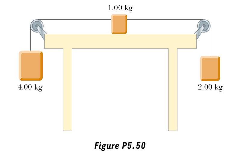

Three blocks are connected on a table as shown in Figure P5.50. The table is rough and has a coefficient of kinetic friction of 0.350. The pulleys are frictionless.
Determine the magnitude of acceleration of each block.
Determine the tension in the two cords.
F=ma
I was thinking that everything accelerates the same magnitude. If so
4g-T1=4a
T1-T2-f=a
T2-2g=2a
Then solving I get a=2.31, T1=29.96, T2=24.32.
I am not sure if this is the right answer, because the problem hints that the accelerations aren't equal. If they aren't equal, can someone show me how to do this?
I didn't check your arithmetic, but your equations are fine. (Everything accelerates together.)
Looks like a typo for T2. It's close to, but not exactly 24.32 N.
24.22N. Sorry.
Looks good to me! :smile:
