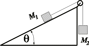

M1 and M2 are two masses connected as shown. The pulley is light (massless) and frictionless.
Find the mass M1, given that M2 (3.5 kg) accelerates downwards at 2.77 m/s2, θ is 25o, and μk is 0.37.

Here's what I've done:
Calculated the force acting on m2 (hanging block)
Fg=3.5*9.81
Fg=34.335
Fma=3.5 * 2.77
Fma=9.695
T=Fg - Fma
T=24.64
Now on to second block
I know these forces are acting on it:
X-direction:
T - Ff - x component of gravity
Y direction
N - y component of gravity
Gravity components:
x = m*g*sin(θ), y = m*g*cos(θ)
I'm only concerned about the forces in the X direction. I know it's accelerating at 2.77 m/s^2
Here's what I put in my calculator
solve(24.64-m*9.81*sin(25)-.37m*9.81*cos(25)=m*2.77,m)
I get 3.4 kg
I have no clue what I'm doing wrong here. This makes sense to me, I really don't understand what I'm missing. Any advice would be greatly appreciated.
The only thing I can think of is if N =/= m*9.81*cos(25) which would throw me off. But I can't figure out why it wouldn't be.

(I haven't checked the arithmetic, but …) the method looks ok to me. :confused:
Why do you think it's wrong?
If we do F = ma in your y direction, a = 0, so your N = mgcosθ is correct.

CAPA (the online program my school uses for physics) says it's wrong... Starting to question whether I believe it.
I get 3.4 kg
I've checked the arithmetic now, and i don't get 3.4 :redface:
(I used 3.5(g - 2.77)/{g(sin25° + 0.37cos25°) + 2.77} … is that the same?)
(standard check … you did use ° and not rad?)
