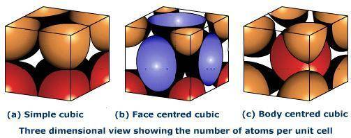

Why can't the atoms along the edge of a body centred and a face centred structures touch each other? Is it something to with the reasoning that somehow if they were made to touch each other then we would not be able to get the face centred and body centred structure?

You took the meaning a bit literally. Though even I am talking about the literal meaning but that is because its written there in the material I am reading from. I am posting an attachment. Please see it. Now, in the attachment, the atoms in the (a) part (simple cubic structure) touch each other along the edges but that is not the case in (b) and (c) (face centred cubic strucutre and body centred cubic structure). My question is why can't we make the atoms touch along the edge in (b) and (c) and still let (b) and (c) be fcc and bcc? Is it not possible to do so? Why or why not?

Yes, it is not possible to do so. Do you see how a lattice is made? I hope you know that those blue, orange and red thingies (they have same radius) are part of atoms. Consider the fcc lattice, try to make the corner atoms (the red and orange) touch each other, do you think there would be enough space left to fit that face-centered blue atom? Simple geometry might help.
Those aren't atoms in the images; those are graphical representations to help visualize the different cubic structures. They are large so that you can see the "cuts" required to show how some of them are shared between the "unit cells". See here for other visualizations: http://en.wikipedia.org/wiki/Cubic_crystal_system

Hmm..Even I thought the same thing..but wanted to confirm it. Does anyone else also say that? I'll go with the majority then. BTW are you preparing for IIT JEE?
