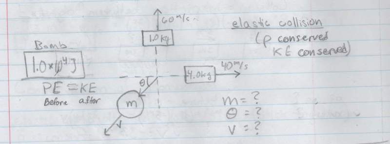

A bomb at rest with 1.0x10^4 J explodes into three pieces.
The first piece is 1.0 kg and travels in the positive y direction with a velocity of 60 m/s.
The second piece is 4.0 kg and travels in the positive x direction at 40 m/s.
Find the third piece's mass, velocity, and angle.
Diagram attached, but link just in case:
http://www.flickr.com/photos/82417987@N08/7545812162/in/photostream

1.0*10^4 = 1/2*(1)*(60)^2 + 1/2*(4)*(40)^2 + 1/2*(m)*(v)^2 <- where m and v are the unknown mass and velocity
Apply conservation of momentum in the x-direction:
The first piece is only in y, so it is not included in the equation. The x-mom eqn becomes:
4.0kg*40m/s + m(ofx)*v(of x) = 0
Now the y-mom equation:
1.0kg*60m/s +m(of y)*v(of y) = 0
I know: m(of x)=m(of y) because both are piece 3. And v^2 = v(of x)^2 + v(of y)^2.
Not sure how to find v(of x) and v(of y)
  • Hand-drawn diagram of a bomb explosion: a 1.0x10^4 J bomb at rest, with a 1.0 kg piece moving up at 60 m/s, a 4.0 kg piece moving right at 40 m/s, and an unknown mass m moving at velocity v at angle theta below the horizontal, with m, theta and v marked as unknown; the diagram is labelled elastic collision (p conserved, KE conserved).
Solve the last two equations for vx and vy. Then plug into the energy conservation and solve for m.
Okay, so
v(of x) = -160/m
v(of y) = -60/m
1.0x10^4 J = (m)*[(160/m)^2+(60/m)^2]
1.0x10^4 J = m*(25600/m^2 + 3600/m^2) = 29200/m
1.0x10^4 J*m=29200
m=2.92kg
then do I use KE = mv^2 ?
if so 1.0x10^4 J = (2.92kg)v^2
therefore v = 58.5 m/s
then v(of x) = -160/m = -160/(2.92 kg) = -54.8m m/s
and v(of y) = -60/m = -60/(2.92 kg) = -20.5 m/s
so theta = inverse tan(-20.5/-54.8) = 20.5 degrees
So:
Mass = 2.92 kg
Velocity = 58.5 m/s
Theta = 20.5 degrees
Can someone verify that?
Thanks
