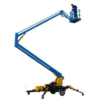

Maybe something Similar to these booms, but without the leveling hold back arms, or whatever that's called
