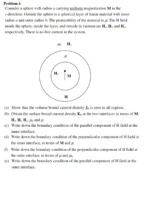

Please see the picture below
1) ##\vec M = \chi_m \vec H##
2)##\vec B = \mu \vec H##
Boundary conditions:
1) ##H^{\perp}_{above} - H^{\perp}_{below}= -(M^{\perp}_{above} - M^{\perp}_{below})##
2) ##H^{\parallel}_{above} - H^{\parallel}_{below} = K_{free} \times \hat n##
The question is as follows:

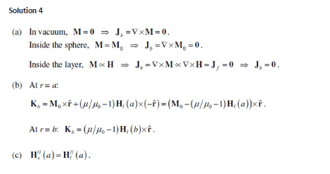

Solutions given only contain part a) to c), which is as follows:
So I now try to attemp d), e) and f).
d)
The magnetic field of a uniformly magnetized sphere is:
$$ \vec B =\frac{2}{3}\mu_{o} \vec M = \mu_{o}\vec H$$
$$\frac{2}{3}\vec M = \vec H$$
The perpendicular component of ##\vec H## is: $$ H^{\perp}_{s} = \vec H \cdot \hat r = \frac{2}{3} \vec M \cdot \hat r$$
e) ##H^{\parallel}_{above} - H^{\parallel}_{below} = \vec K_{free} \times \hat n =0##,
Therefore, $$H^{\parallel}_{l}(a) = H^{\parallel}_{s}(a)$$
f)
By $$\oint \vec H \cdot d\vec a= - \oint \vec M \cdot d\vec a$$
$$ H^{\perp}_{above} - H^{\perp}_{below}= -(M^{\perp}_{above} - M^{\perp}_{below})$$
Given that:
##H^{\perp}_{below} = \vec H_{s}(a) \cdot \hat r##
##M^{\perp}_{above} = \vec M_{above} \cdot \hat r = \chi_{m} \vec H_{l}(a) \cdot \hat r##
##M^{\perp}_{below} = \vec M \cdot \hat r##
Therefore, $$ H^{\perp}_{above} - \vec H_{s}(a) \cdot \hat r = - (\chi_{m} \vec H_{l}(a) \cdot \hat r - \vec M \cdot \hat r)$$
$$ H^{\perp}_{l} = - (\chi_{m} \vec H_{l}(a) \cdot \hat r - \vec M \cdot \hat r)+ \vec H_{s}(a) \cdot \hat r = - [(\frac{\mu}{\mu_{o}}-1) \vec H_{l}(a) \cdot \hat r - \vec M \cdot \hat r] +\frac{2}{3}\vec M \cdot \hat r$$
I cannot proceed further, or I do not even know if I am correct. Can anyone give me any advice?

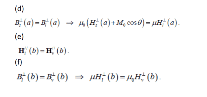

The solution is finally released:
Do you see how they did part (d)? They had to use ## H_s ##, which can have contributions from the outer layer.
If the outer layer is absent, then ## H_s ## is uniform throughout the entire interior of the sphere including ## H_s(a) ## and is then ## \vec{H}_s(a)=-\vec{M}/3 ##.
With the outer layer in place, they don't ask you to compute ## H_s ##. That would be rather difficult, and they simply want the boundary condition for now.
The outer layer is magnetized and radiates H field, which alters the H field inside the sphere, am I right?
Tony Hau said:
Therefore,
Right after "Therefore", you should have ## M_s ## in that expression, not ## M_l ##. Otherwise, part (d) that you have there looks correct to me. :)
Yes, and it is not uniform and not simply in the z-direction, like the ## H ## field is inside the sphere for the case of no outer layer. With no outer layer, the ## H=-M/3 ## field inside the sphere is much simpler.
