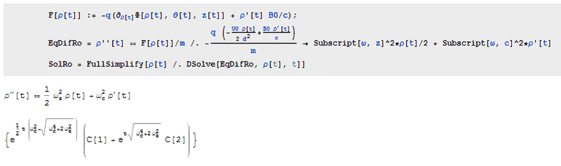

For the radial component, there IS influence from the magnetic field. Lorentz force (the cross product simplifies since the radial component is perpendicular to the field) and simplification into two frequencies (q U0 / (md^2) for wz and q B0 / (mc) for wc:
Mathematica screenshot: definition of force F, the equation of motion EqDifRo, DSolve output, and the general solution SolRo with constants C[1] and C[2].
Mathematica notebook screenshot: definition F[rho[t]] := -q(d_rho[rho[t], theta[t], z[t]] + rho'[t] B0/c); then EqDifRo with rho''[t] == F[rho[t]]/m, DSolve result, and SolRo simplified to a solution in exponentials with constants C[1] and C[2].
There's something that doesn't look right to me here.
In the first line that gives the expression for F[##\rho##[t]], doesn't the last term ##\rho## '[t] B0/c represent a component of force in the azimuthal direction rather than the radial direction?
That's one thing I'm confused about too. In the place I read about, (it's the second link in my "Relevant equations"), they put the equation of movement in like that. I tried figuring it out but I'm not really sure about it.
So the force would be perpendicular to the particle's tangential velocity and the field, which means it'd be in the direction of radial velocity, no? That's how I perceived it. Since it's Cross[B, v] by definition.
Look at equation 2.11 in your link and note that ρ is a vector in the x-y plane. The second term of the equation is a cross product of vectors.
