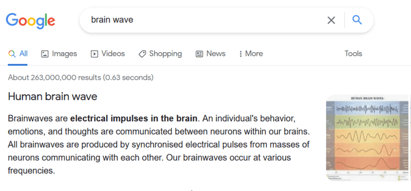

If you would learn how to use Google, you could answer simple questions like this by yourself:

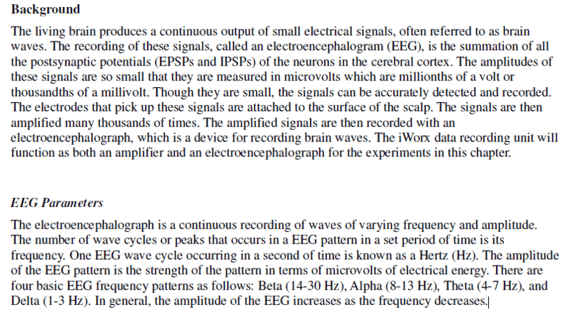

Okay, after some post deletions (persistent misinformation from CoolMint) and cleanup, the thread is reopened. @CoolMint has also been banned from replying in this thread going forward.
Just to clarify the level of EEG signals (which I do have good experience designing circuitry to measure):
https://www.google.com/url?sa=t&rct...lArousal.pdf&usg=AOvVaw1Zna1QlytXncEFWRjXGwLS
