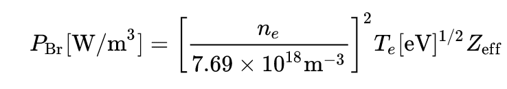

3) Finally, the question n ° 3) concerns the expression of the total power emitted per unit of volume, according to what I have on Wiki, this quantity is equal to :
##P_{\mathrm {Br} }[{\textrm {W/m}}^{3}]=\left[{n_{e} \over 7.69\times 10^{18}{\textrm {m}}^{-3}}\right]^{2}T_{e}[{\textrm {eV}}]^{1/2}Z_{\mathrm {eff}##
Here the formula :
The total power would then depend of : the temperature ##T## of the plasma, its density ##n## and the number of charge ##Z## of the ions of the plasma: is this correct?

(1) In a plasma, electrons are accelerated when they make Coulomb collisions with the heavier ions. The radiation produced is considered "bremsstrahlung", whether the electron is experiencing acceleration or deceleration. This may not be linguistically correct, but this is the common usage.
(2) You should be able to find information of the spectral distribution. For example, the Wikipedia page gives the spectral distribution dP/dω.
(3) Yes, the total power depends on n^2 T^(1/2) Z, as you described.

Just a last question : shouldn't be rather ##P_{\mathrm {Br} }[{\textrm {W}}/{\textrm {m}}^{3}]={Z_{i}^{2}n_{i}n_{e} \over \left[7.69\times 10^{18}{\textrm {m}}^{-3}\right]^{2}}T_{e}[{\textrm {eV}}]^{\frac {1}{2}}## ? I mean with a ##Z^{2}## factor ?
instead of non-square powered factor ##Z## ?
By the way, where does this difference come from (between single ##Z## and ##Z^{2}## into power formula ?
Regards
In a fully ionized plasma, how do ni and ne compare? How does the formula you wrote in post #1 differ from the formula you wrote in post #3?
In the first one, I have ##\propto\,Z_{eff}## and in the post #3, I have ##\propto\,Z_{i}^2##, is there a link between ##Z_{eff}## and ##Z_{i}^{2}## ?
Zeff is just the average Z for a multi-component plasma. Zi is the Z of the ion. For now let's assume the plasma is composed of only one element and Zeff=Zi=Z. You didn't answer my first question. In a fully ionized plasma, how do ni and ne compare?

I thought I gave a simple explanation. I don't want to just tell you the answer. You need to put some effort into thinking about it. In a helium plasma ne = 2 * ni. What is the general relationship between ne and ni for a nucleus of charge Z? How does this answer your question about the difference between your two equations? If you can't answer questions like this, how do you expect to do physics?
you might want to say that ##Z_{e}=1## for electrons and ##Z_{i}=2## for ion, so ##Z_{e}\,Z_{i} = Z_{i} = Z_{eff}## ??
No, you're still not getting it. The point is that ne = Z * ni. So your first equation, which has ne^2 * Z is the same as your second equation, which has ne*ni*Z^2.

so could you confirm that actually, with a full ionized gas of Helium, we have : ne = Zi ni = 2 ni :
Yes, this is correct. What would the relationship be for a fully ionized gas of oxygen?
