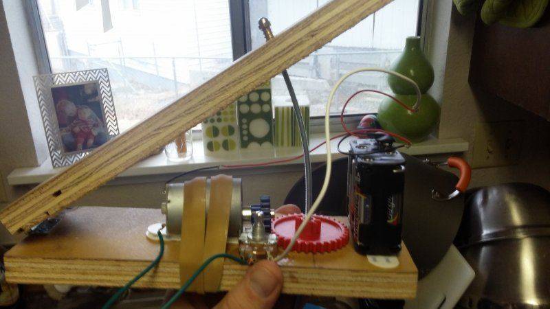

Has anyone here built one before. I've got a nearly completed one but I am afraid its not stable enough to keep on track.

Because... I need to know if there is anyone in this section who can answer this question. No point in giving a bunch of details if the isn't anyone who can answer questions.
Primarily I have a 3.5 rpm motor stepped down to1 rpm with connecting gears and a 1000 ohm potentiometer. The 1 rpm gear has a threaded rod running through the center that is bent to a radius of curvature of 7.15". I determined this by creating a chart comparing the change in length of the third side of the triangle created by the opening of the barn door to the arc length of a perfect circle.
The problems I am noticing is that the tip running from the motor into the first gear is slipping and skipping. And some spots on the rod get stuck in the gear and the speed changes. Ill get some pics up soon. I am just looking for some general tips for ensuring proper guidance.

Bending the threaded rod effectively changes the thread pitch. The threads on the outside of the curve spread out and the inside threads move closer together. From your description, I suspect your problem is there.
Try using a straight or straighter rod. It could be straight as long as the ends could pivot a little -right? How much angular travel do you need?
Or you could (triangle) file the threads around and around smoothing, rounding and reducing their size. That might reduce the interference enough. You will have more backlash but as long as the load stays in the same direction it won't matter.
Other than that, pics or even a video would help us help you.

Good pics and cool project! And I understand your dilema. I have questions.
First. does it drive up opening the angle or down?
How is the gear attached to the motor shaft? It appears to be a decent (1/4" ?) sized shaft. Does it have a flat you could use a set screw on? Is it splined?
Worst case you could drill and pin it. That would solve the slipping and skipping but I still think the majority of your issues are coming from the curve.
With the rod and red gear alone, the gear should spin smoothly along the rod. Any dragging or hanging will only be worse when loaded. A snug fit is working against you. Does the red gear have a threaded metal insert or is it all plastic?
Would it be possible to scale up the radius and run the motor faster? That would give a gentler curve and reduce the error in thread pitch.
In the pic the rod doesn't appear to be a smooth continuous curve. Or is that just an illusion? Where the windowsill is behind the rod it appears to be a shaper bend.
Does the mesh of the gears give you any trouble? From the pics they look ok. But they aren't bevel gears are they?
Under the red drive gear for the rod did you use a bearing surface? (UHMW or similar) That might help as well.

It is 1/4 and has a flat I tried to rig it with a piece of plastic in the hole, it looks tight but whenever it has even a little resistance it starts slipping. I am not super familiar with rigging gears I was also having trouble coming up with a way to keep the red gear stable (it does start to tilt up occasionally) how would i go about finding a screw to hold the gear to the motor better and also hold down the red gear, i think that's where I am having issues.
The gears are working together perfectly together they are plastic. The rod is a near perfect curve for about the middle six inches, the rest is a little off. But because it takes a min for a full rotation it takes 32 min for an inch. Any exposures over 12 minutes suffer from sensor heating problems, light pollution ect. To take many photos i won't ever need more that 2 to four inches of uninterrupted regular threading. (Im thinking of attaching a polarity switching switch and rotating the mount.
Oh and I have it closing to help keep the red gear in place but because the axis has to be oriented to true north i can reverse polarity and rotate the mount 180 degrees.
The red gear isn't threaded so i screwed a double threaded screw (inside and out) tightly into it and it spins smoothly (most the time on the threaded rod)

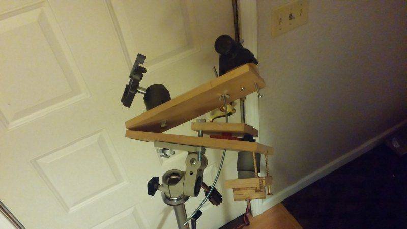

Hi Scott
I can see a number of mechanical problems that will cause instability ...
1) your hinge area is too small for the width of the section you are hinging ... you need a wider hinge to make the platform more stable
2) Motor rubber banded in position ... seriously ... that should be an obvious stability problem ;)
3) plastic gearing you could almost get away with, but when combined with really coarse teeth is a recipe for problems
you will find there is too much slack / play in the meshing of the teeth
finer toothed metal gears are a much better solution :)
4) and on top of all this ... how much camera and lens weight are you expecting this construction to be able to handle ?

It has held up to 9 lbs without any noticable effect on the system and the motor has a mount but I am waiting to perma fasten it till I solve the gear slippage problem.
The primary problems are slipage of the gear to motor connection and the other gear rising up off of the platform. montoyas7940 mentioned a fix for both of these problems but I am little confused as to the parts needed and where to find them. ☺
Solving the slipping black gear is easy since you have a flat on the shaft.
Drill a hole between the teeth of the small unused gear portion of the black gear and secure it to the flat of the shaft with a set screw in the hole. Set screw diameter doesn't matter much since you aren't using that portion of the gear, 3/16" or 4mm should be about right. Be careful not to drill the hole too large as it is an easy mistake to make. The hole should be about equal to the minor diameter of the set screw. Google drill and tap size for more detail. Get one with a coarse pitch since it has to grip plastic. You might have to actually tap threads into the set screw hole but you could possibly get away with brute force. Filing (triangle file) a notch along the set screw length will make it somewhat self tapping as it creates a cutting edge and a way for the plastic chips to move out of the way. Or you could just buy a cheap tap (I probably would). Your profile doesn't tell where you are. Do you have a Lowes or Home Depot or really any decent hardware store nearby? You could order everything online but I think you will get a better feel for the sizes you need if you carry the gear with you to the store.
Just pausing to say I really hope I am not insulting your intelligence with this. I don't know how much you know and if I have, I apologize.
Anyhow, on to the red gear. Two possible solutions to the riding up problem depending on the cause. One is rotating the motor and black gear so they are inline with the red gear instead of perpendicular. (Motor off the side maybe) The other is to sandwich the red gear between bearing surfaces. Something simple such as delrin sheets top and bottom separated by spacers (washers, short pieces of tubing or whatever) or delrin sheet on bottom and a couple of square rods across the top (also spaced so the gear can rotate). Even if you rotate the motor and black gear I think a bearing surface under the red gear would help.
I hope this is helpful and coherent. I've been up 26 hours, going to bed now.

Perfect! Exactly what I needed to know. Thanks!

Finished build three of the barn door tracker. I've been able to track up to 10 min so far with absolutely no trails ☺
