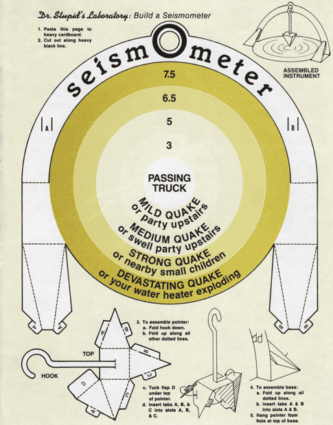

As usual. Tom Waller's fabulous and, sadly, out of print, book Science Made Stupid, has the answer:
