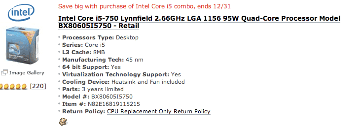

Hello all. I am looking to build a new PC. I really know very little about computers, but since my degree seems to be
leading me into the computational realm, that will need to change quickly. Instead of just *building* a PC and going
through the motions, I would really like to *learn* what exactly it is that I am doing. I want to learn about the components
themselves and how they are specced out. So I would like to first talk about processors, since I believe that that will be the
main component that I will need to choose and the rest will follow suit. Then I hope that this thread will evolve into a
discussion about the remaining components.
EDIT Added for clarity: I suppose I should say what the PC will be used for, since that will dictate many choices: I am not a gamer, but I will possibly use the PC to do some simulations (i.e., CFD or FEA). I am getting into programming quite a bit, but will probably never take it to a professional level. I use tools like Mathematica and MATLAB a lot.
So here is what I already (think that) I know: The higher the processor speed and the more 'cores' the faster. That's all I know. So maybe
we can use a specific processor as an example and talk about what each of the specs means:
Intel Core i5-750 Lynnfield 2.66GHz 8MB L3 Cache LGA 1156 95W Quad-Core Processor
http://www.newegg.com/Product/...6819115215
I have wikipedia'd these, but it's a little wordy; maybe someone could paraphrase for me:
L3 Cache
Manufacturing tech (they are all the same, so I guess I don't really care about this one)
What does the "LGA 1156 95W" mean?
What is the difference between the one I linked above and this one? http://www.newegg.com/Product/...6819115131
They are both Quad core 2.66GHz. What does the other stuff mean?

Socket LGA 1156 rated at 95W. That is, you won't be able to put the processor into mobo that doesn't have this socket type and is not able to supply 95W to it.
L3 cache - do you know what memory cache is? In short - that's a very fast memory sitting in processor and mirroring content of RAM, used by processor to speed up access to the code and data. L3 means there are three levels of cache, and L3 cache has 8 megabytes. In general - the more, the better.
This comes across crystal clear. Thanks Borek. :wink:

http://en.wikipedia.org/wiki/Intel_Nehalem_(microarchitecture)" family of processors (though it can handle the Core i3 and Core i5 processors, too).
LGA 1156: Lynnfield (Core i5-7xx, Core i7-8xx, Xeon X34xx). Quad-Core 45 nm Dual-Channel, PCIe - performance/mainstream desktop socket set.
LGA 1366: Bloomfield (Xeon 35xx and Core i7-9xx). Quad-Core 45 nm Triple-Channel - extreme/performance desktop socket set.
If you want to wait, the Gulftown (also LGA 1366) is a six-core, hyperthreaded processor to be released Q1 2010 in Core i7-980X.
