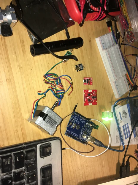

So, I've bought a bunch of stuff which I hope will prove helpful in building the laser profiler and some that will fit with the multipurpose spectroscopy card, as it can't just sit there without doing some good. Especially not at that price. Specifically this gizmo:
SparkFun Serial Basic Breakout - CH340G
I bought a 100mW laser which the ad said can cut stuff(?), and yes, I know it doesn't make much sense. I was a litte inebriated and added it to my order before the absurdity dawned upon me. It made the shipping free though, didn't cost much, and anyway you can never get enough lasers!
I also bought some stepper motors. One of them pretty random but the other one I'm reasonably sure can be used for the laser profiler:
Stepper Motor - 32 oz.in (200 steps/rev, 1200mm Wire)
I also ordered a "3.3V-5V 3PIN Photodiode Module LM393 Light Sensor Switch Module for Arduino Raspberry Pi Photosensitive Diode Detection Switch"
As always: No affiliation.
EDIT: Heh, silly little fact: without physical or mechanical schooling it took me a little while to wrap my head around what the lead in leadscrew referred to. Must admit I initially was a little nonplussed as to why this screw had to be lead (as in the element)(?)!
