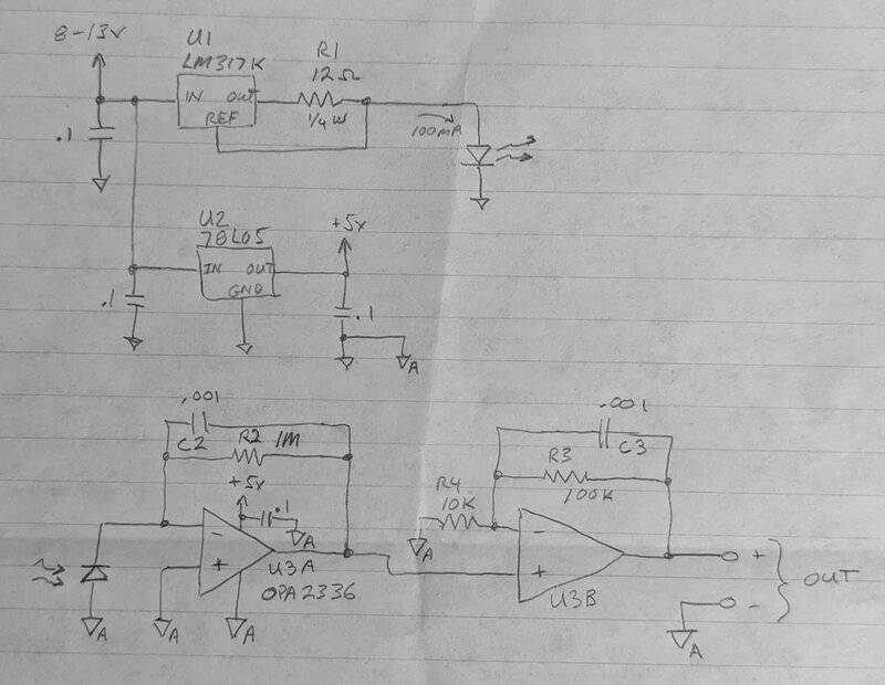

_maxim_ said:
I need just a simple schematic diagram
OK, try this one. The simplest possible version, I think.
I usually hesitate to do this because there's a lot to know about building circuits that isn't in the schematic. If you don't mostly understand this, you'll need to get the help of someone familiar with circuits, I think. The last amp stage may not be necessary, or may need the gain adjusted; I just guessed at that (honestly it's the only way to do this since we don't know how much light gets through your system).
Next (first?) you need to deal with @berkeman's question. What will you do with the voltage out from this circuit?

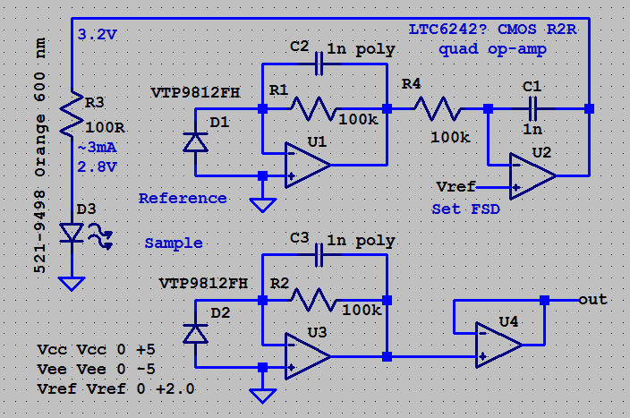

The problem with a LED source is that, for a constant current, the light output reduces with temperature. If you build only one channel, you are building a thermometer.
With one 600 nm LED as a source, two identical detectors are needed. One detector is used to regulate the LED light output, at a set point on the reference detector. The other detector gives the transmission through the sample. That arrangement will give reliable results.
To get precision results, you will need to greatly attenuate any stray background light levels. If that cannot be done, you will need to chop the LED light, to get an estimate of the background light level.

Your scheme with constant current source on the LED and precision op-amp chain on the receiver is very practical and interesting...
I would say, a very good starting point. Thank you so much for having shared it.
I just have to solve the voltage demand higher than the 5Vdc provided by the ESP32 SoC...
The LED requires about 3V, as I recall. So you can power it from 5V, just not with that IC. It could be as simple as just a resistor. Or you could design a low dropout current regulator in a few different ways. But that's a bit more complex.

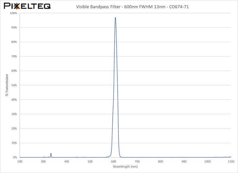

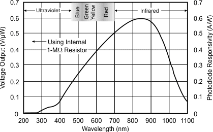

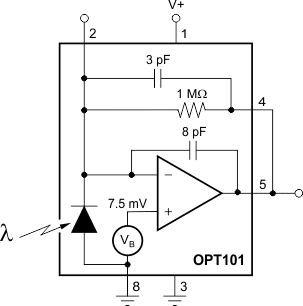

What about using a common OPT101 on-chip transimpedance amplifier photodiode?
Probably a 600nm bandpassfilter like this could help to select the wanted radiation
Yes, but you'll lose a lot of the LED emission spectrum. Also, it doesn't stop unwanted radiation within the passband. Something wider is probably better to maintain a high signal, assuming the absorption spectrum of your cells is also broad enough. Get rid of the unwanted radiation within the passband too. Like the cardboard box idea.

DaveE said:
I still prefer the cardboard box idea.
That is a good start. Keep it simple. Paint the inside of the box matt black.
Here is a concept schematic for a two channel instrument that would probably do what you need.
The output voltage will be between 0 and Vref, say about 2 volts.
The output amplifier can be adapted to the signal destination.
Maybe with the careful choice of CMOS R2R op-amp, it will not need a negative supply.
