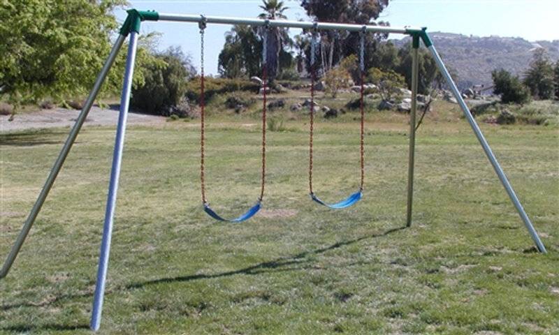

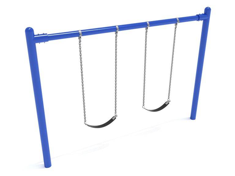

Hi all,
I designed this swing set and now I'm doubting my self and getting concerned.
I used 5" schedule 40 steel pipe for the posts and 3" schedule 40 steel for the top horizontal bar. There's only one post per side to be set 48" down in concrete 16" in diameter. This designed is to help with limited space in the area.
The design is to be 12' from the ground to the top bar with two swings. Am I pushing my luck for rigidity?

Have you fabricated this yet, or is it just on paper so far? Is there a reason you went with single posts on the ends instead of the more traditional A-Frames?
https://discountplaygroundsupply.com/8-high-2-seat-swing-set/
berkeman said:
Can you post a sketch? Use the "Attach files" link below the Edit window.
The reason for the single post design is limited space.
It's basically a copy of this, except 4' higher and 1 size larger pipe and substantially larger footings, I think the commercially available design only calls for 32" deep. I'm considering on shortening it as maybe 4' higher is just too much for 1 size larger pipe.
But, maybe not? The pendulum effect is what's throwing me off rather than just static load.
This design uses 4" sch40 pipe for the side posts and is only 8' above the ground.

I'm not understanding this. If you look at the typical picture that I posted, the A-frame triangles basically reach out to about the same distance that the folks on the swings will be swinging out to. If you don't have room for the A-frame triangles, how do you have enough room for the folks swinging?
It seems to me that you are not.
I am not sure about the rigidity of the "3" schedule 40 steel for the top horizontal bar".
How wide apart will the vertical posts and the swings be?

138" between posts.
That feels really shallow for anything taller. There will be some serious torque at the base, repeatedly. The pipe likely will be able to bear it, but the soil?
Also, it was already asked but without response: if you don't have enough space then how do you plan to address safety and swinging (flinging... o_O ... landing) width?
If it's just the problem of standing area but you have adequate (soft) ground for swinging width you may consider to attach the stand to somewhere at the top too.
Comparing both designs for buckling:
$$\frac{\left(\frac{5.5^4 - 5^4}{12}\right)}{\left(\frac{4.5^4 - 4^4}{8}\right)} = 1.255$$
So your design should be stronger than theirs.
Comparing both designs as a cantilever beam with a load at the end (for any horizontal load at the top of the swing):
Comparing the shear stresses:
$$\frac{\left(\frac{5.5^2 + 5.5(5) + 5^2}{(5.5^2 - 5^2)(5.5^2 + 5^2)}\right)}{\left(\frac{4.5^2 + 4.5(4) + 4^2}{(4.5^2 - 4^2)(4.5^2 + 4^2)}\right)} = 0.81$$
Your design is weaker than theirs.
Comparing the bending stresses:
$$\frac{\left(12 \times \frac{5.5}{5.5^4 - 5^4}\right)}{\left(8 \times \frac{4.5}{4.5^4 - 4^4}\right)} = 0.97$$
Your design is slightly weaker than theirs.
