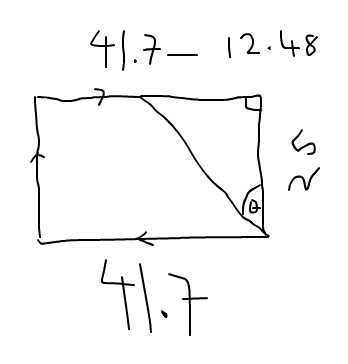

1.A aircraft leaves base and travels west at a speed of 100km/hr for 25 minutes, then turns right and travels north at a speed of 25m/s for 1000 seconds, then turns right and travels east at a speed of 75 km/hr for 10 minutes.
The plane is asked to return to base. Determine the direction that the aircraft must take to return on a direct path and describe this as a position vector.

I have converted all the answers to m/s i.e. 100km/hr /3.6 constant = 27.8m/s 25m/s 75km/hr /3.6 constant = 20.8m/s
then converted the time to seconds 25 min = 1500s 1000s 10min=600s
distance = speed *time = 27.8ms*1500=41.7km 25*1000=25km 20.8ms*600secs=12.48 km
then drawing diagram from base position resulted in 41.7km west, 25km north, 12.48km east.
I know i am suppose to use trigonometry but the diagram does not look like a triangle. Please help
You need to find the displacement of the aircraft from the starting point. Are you familiar with unit vectors?
Actually, forget the unit vectors, the cardinal directions work fine. If you travel 10 km west and then 5 km east, how far are you from where you started?

11.2km away using the pythagorean theroem. I understand i would be able to draw a clear triangle diagram and then find the angle and the distance.
would i connect the lines between west 41.7 km and east 12.48km to the base position therefore drawing a triangle ?
No, you would be 5 km away from where you started. Here, look at this diagram.
The dotted lines represent the displacement vectors north and west. I do not know if this diagram matches your problem exactly, but it should be something similar.
The arrow on the displacement vector to the west should be going the other way, actually.

Okay i think i understand from your diagram. this is because the resultant vector is from the start point to the end point, then you have drawn a triangle. Would my calculations be right in assuming the length of each side. then using pythagorean theorem and tan^-1 to find the angle.

Yes! The actual angle that the aircraft has to turn through would be 90 - θ, though.
