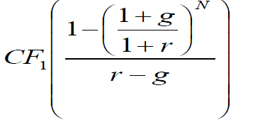

Hi all
Trying to improve my level of maths and would like some help with the below question please.

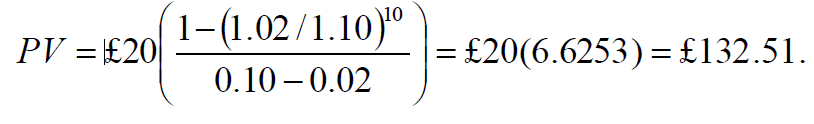

A 10-year lease with annual rental payments to be made at the end of each year, with the rent increasing by 2% each year. If the first year rent is £20 and the OCC is 10% per year, what is the Present value of the lease?
The formula for present value of a level annuities is below (for a growing interest rate)
According to my book the answer should be £132.51, but I get -23.88.
Could anyone tell me where I am misinterpreting the formula?

Book is correct. Are you using a calculator?
You're probably entering the data wrongly...we can't tell...
Try it this way:
u = (1.02/1.10)^10
v = .10 - .02
PV = 20*(1 - u) / v
Yes it works I must have been using the incorrect figure with my calculator.
Many thanks
